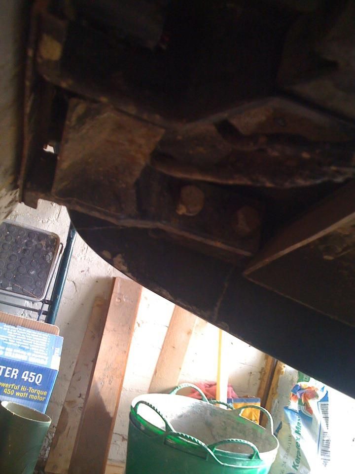

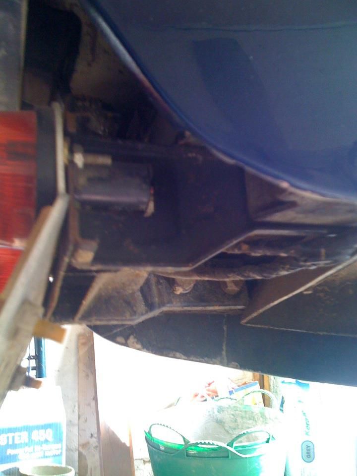

just wondered if this is off another gpz, quite fancy getting something almost standard looking but without it sticking out from the body work like the original

That's a common mod where the bracket is simply shortened.
Ginger Bear has done it recently.

no havent got the original mudguard, i meant bracket :lol:
so this bracket is shortened? the part with 4 bolts to the subframe?
thats mud not rust by the way :lol:

#7 PostAuthor: captaincaveman » Mon Dec 31, 2012 6:00 pm
bumping this back up, any ideas on how i cut the bracket?

#8 PostAuthor: steve.w » Mon Dec 31, 2012 6:42 pm
make a bracket ..just a flat one and fasten in to the two threads on the end of frame tubes ..big green bus ..is the man to talk too as he had some made :wink:

steve.w wrote:make a bracket ..just a flat one and fasten in to the two threads on the end of frame tubes ..big green bus ..is the man to talk too as he had some made :wink:
thats an idea, i didnt want to cut this one down if i could help it, so pretty much a u-shape out of ally then? :D

#10 PostAuthor: tlc » Mon Dec 31, 2012 9:19 pm
If you just take that bracket off you will see 2 x M8 threads in the rear of the seat rails. Just get a bit of flat on there and mount your lamp.
It's almost as if that's what Kawasaki wanted you to do in the first place.

#13 PostAuthor: captaincaveman » Mon Dec 31, 2012 11:15 pm
tlc wrote:If you just take that bracket off you will see 2 x M8 threads in the rear of the seat rails. Just get a bit of flat on there and mount your lamp.
so literally on the end of the round tubing then? ah ok i thought you'd have to bolt onto where the existing 4 bolts/bracket are? that sounds easy
now a silly question, what happens with the rear bodywork? mines held in place by a bracket with a slotted square rubber mount? :D

#14 PostAuthor: steve.w » Tue Jan 01, 2013 9:34 am
u make a little bit ta put the rubber in :wink:
