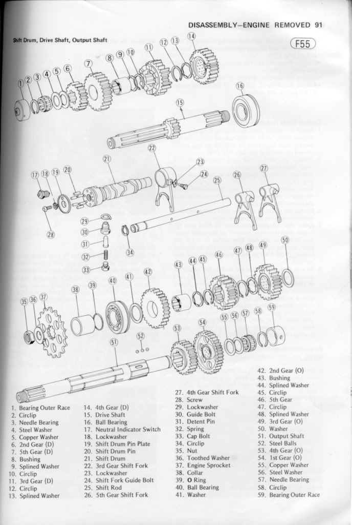

Help is urgently required. I've done this job before a couple of years ago. What I'm doing is changing the gearbox shaft and keeping the gears!
This is the shaft with the three - 3/16 balls.
How do I get those balls out... I have an idea I used to spin it?

Once all the circlips, thrust washers and cogs are removed isn't the hole through which the balls were installed visible? I think this is the case.......though I could be wrong.

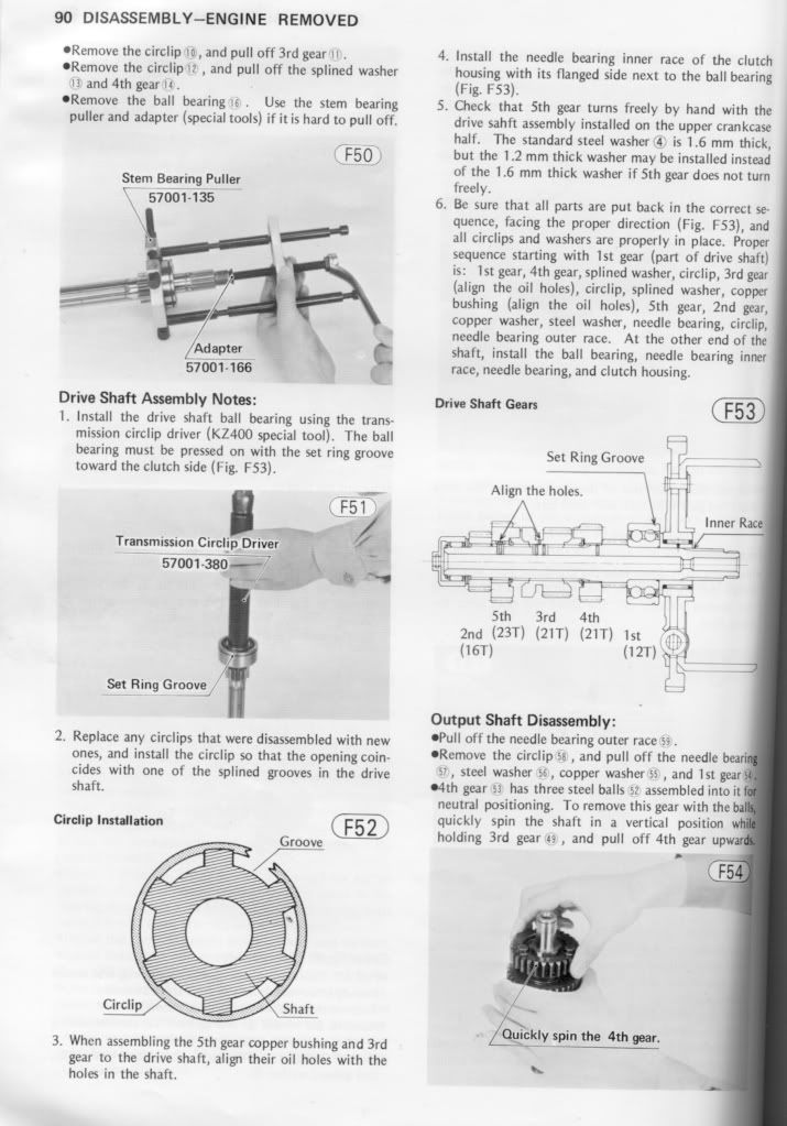

Thanks, for the reply George, I've looked at that hole and it does look as so it's part of the solution. However, I seem to remember just spinning the shaft allowing the balls to locate somewhere and "presto" the gear just slid off. All the manuals are vague in this area. One manual (Clymer~ Kawasaki Z1 early ed) says "Pull off 4th rear, turning the shaft as necessary to align the 3 steel balls".
Here's something... (Clymer ~ Kawasaki 1973-1980)
"Pull off 4th gear. To remove the gear, spin the shaft in a vertical position, holding onto 3rd gear. Pull the 4th gear up and off the shaft".
Maybe I should wash in petrol to remove any grease that may be hindering the balls from moving?
RegardZ.

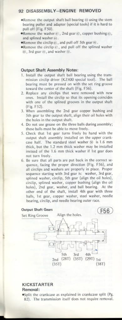

I guess you've done it now but here are the pages from my z1000 workshop manual.
Hope this helps.

#7 PostAuthor: Garn 1 » Sat Oct 03, 2009 10:41 pm
PopsA1, You may have thought your contribution to my problem was too late.... It wasn't!
I read on the last page of your workshop manual, "Output Shaft Assembly Notes ~ Item 4", not to use grease on the balls when assembling. I had used grease on one ball, relying on gravity (in a horizomtal position) for the other two. I have since washed it out. Also, though not relevant this time, was Item 5, which talks about the two thincknesses of washers used in this assembly.
Thanks & regardZ.

These pages are from the Service Manual published by Kawasaki in 1977 and covering the A1, A2 and D1 models.
If anyone would like a specific section just PM me.
