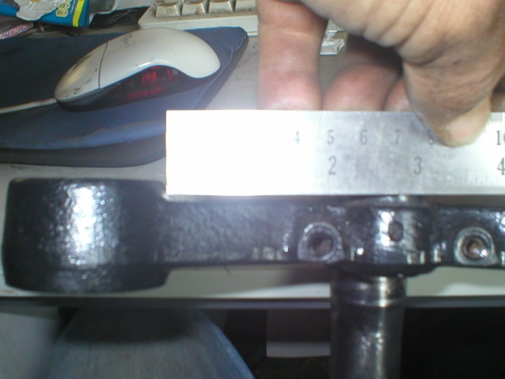

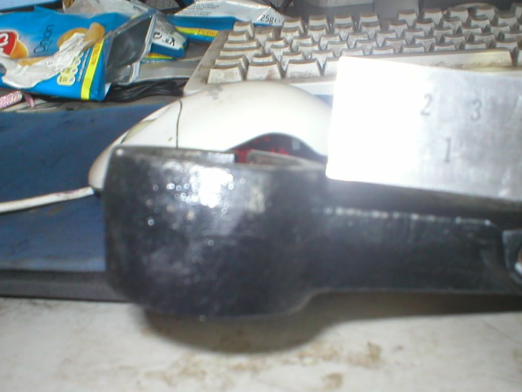

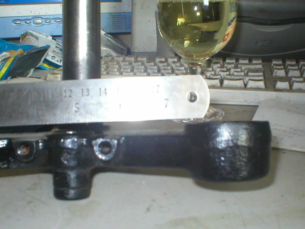

#10 PostAuthor: hillbilly » Fri Aug 21, 2009 6:32 pm
maybe not to clear,but the ruler was touching both sides of the yolk on one side,and the other end was deffinately out a fair bit.problem solved,cheers jack. :lol:
