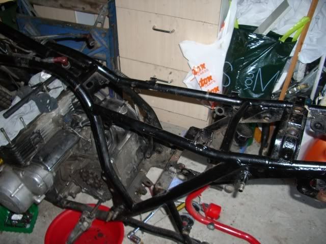

Decided to have a quick look at the engine :??
I removed 6 off the 8 exhaust studs, one has snapped off, another very tight. Oh well, best whip the head off then :roll:
Cam cover & carbs are off, once HT leads are removed, cam cover wriggles off towards rear of head.
Loosen cam journal bolts evenly, and centre roller guide. Remove roller guide (mine has mucho play!) and tie sumink to cam chain so it can't fall down tunnel. Now cam caps can be removed (numbered as machined precisiely to each position in head!) and camshafts.
Its important to work methodically and NOT mix up position of parts. Lables and/or photos help.
I've marked the shims & buckets for easier replacement, even tho I'll have to recheck & probably re-shim later.
Barrel look & feel really good. No scars, scratches or marks :lol:
I need to remove one stubborn exhaust stud & another on has snapped off flush :cry:

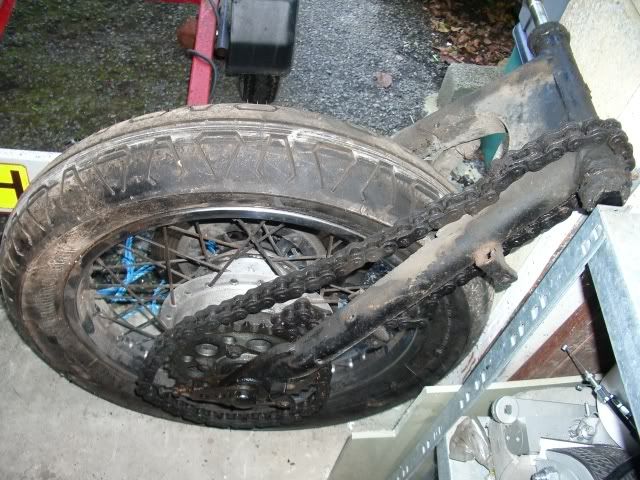

Got the bike stripped down ready for a frame swap at Staffs :shock: with a fellow member :twisted:
This bit was surprisingly, wheelie easy to remove, s/arm spindle slid out no bovver :!:
Getting the engine sprocket off was another story tho :cry: bl**dy endless chains. Been torqued up by Jeff Capes & a 12ft scaffold bar :evil: Shame there's not enough room to lift the chain off the sprocket without having to undo it :roll:

#12 PostAuthor: Muddychris » Thu Oct 18, 2007 7:30 pm
I had too split my chain to get it off. Bought a new link cost me ?5, Happy with that.
Chris

#13 PostAuthor: Pigford » Thu Oct 18, 2007 7:38 pm
Muddy, I'd have got me grinder to it, but had to strip the frame down, so didn't matter too much.
I did have a split link, but when I fitted my billet engine mounts, what with the off-set sprocket, the link came off - see marks in mount - but luckily I notice it missing when cleaning the bike :shock:
I only use rivet links now.

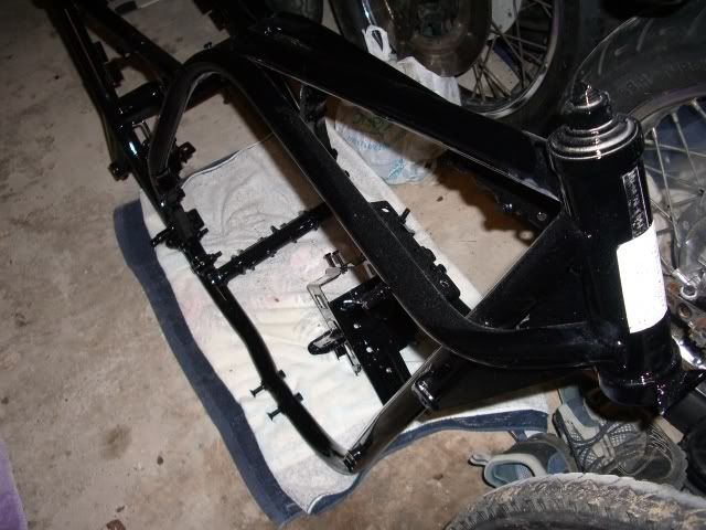

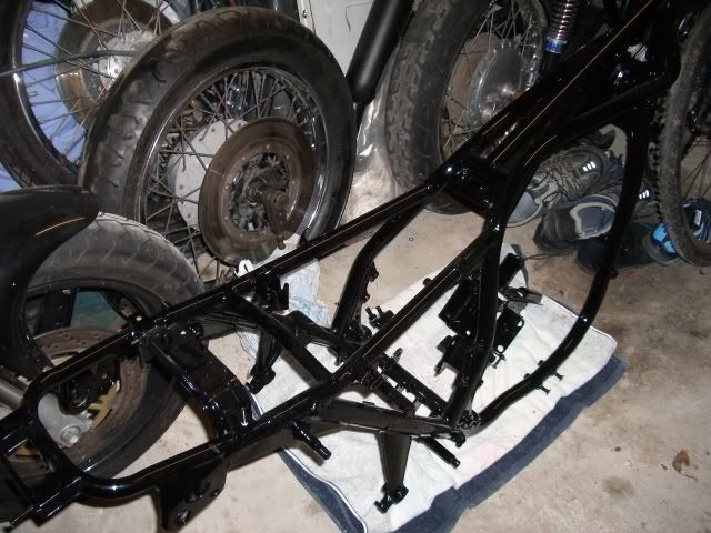

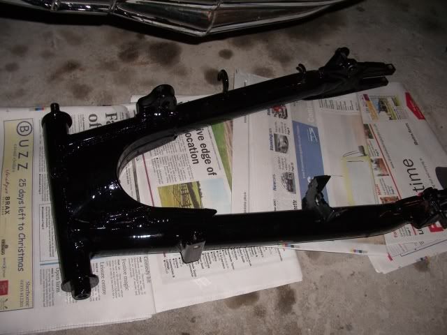

#15 PostAuthor: Pigford » Mon Dec 03, 2007 6:30 pm
Got me frame, swingarm & battery box back from the sprayers:
Apparently, coz it was only just finished today, I gotta leave it for a few days to harden fully.
Its been blasted, had 1 coat primer, rubbed down, another epoxy primer coat. Then 2 x coats (2-pack) black. Nice job for me ?100 + a bottle of scotch :P
Mikey's got the casings ready for collection this coming Saturday, so I'll put them on here at the weekend :wink:
