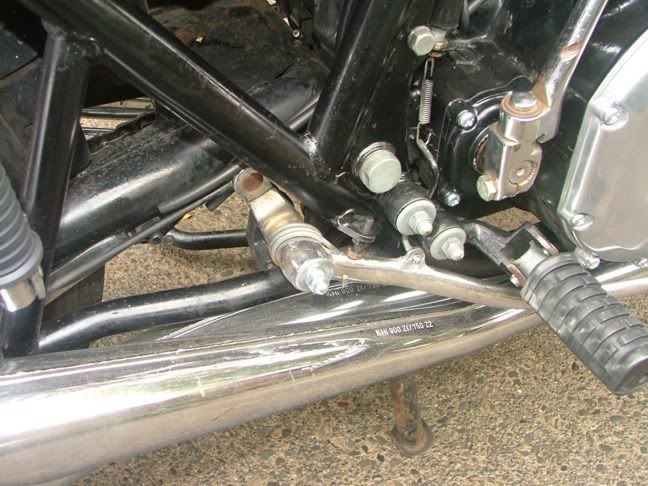

I've since sourced the correct lever bolt. For the red colouring that goes on the choke and kill switch I used a product called "Rub and Buff" Mandarin. It's basically pigment suspended in wax. I think the colour is as correct as I'm going to get it. Note the control hasn't been repainted.
Spot the El Cheapo pipe fix. It will have to do until I come into some money.

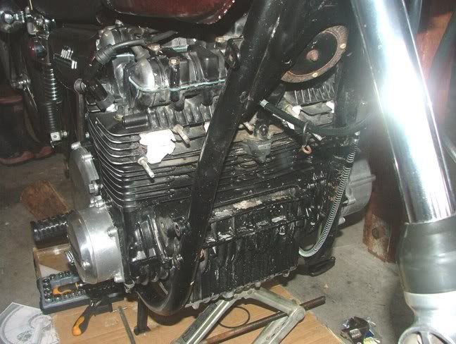

I've only spent about two and a half hours filing the fins so I'll have to go back and revisit that job. MaineKZ spent six hours on his so that sets the benchmark.
A big thanks to Pigford for posting off hard to find emulsifier tubes. The PO of my bike had managed to bend the original ones. Now that's hard to do! Thanks to Mikey for plating advice and also bunnyZ for services rendered. Also, the membership here has given me great advice over the past 18 months or so. Cheers.
This restoration is really just a once over lightly to get rid of the stuff I couldn't live with. I've kept as much of the original paint as I could. The body set is 100 percent factory paint and the frame about 80-90 percent. The engine was spray bombed by the PO so I have just done my best there.
