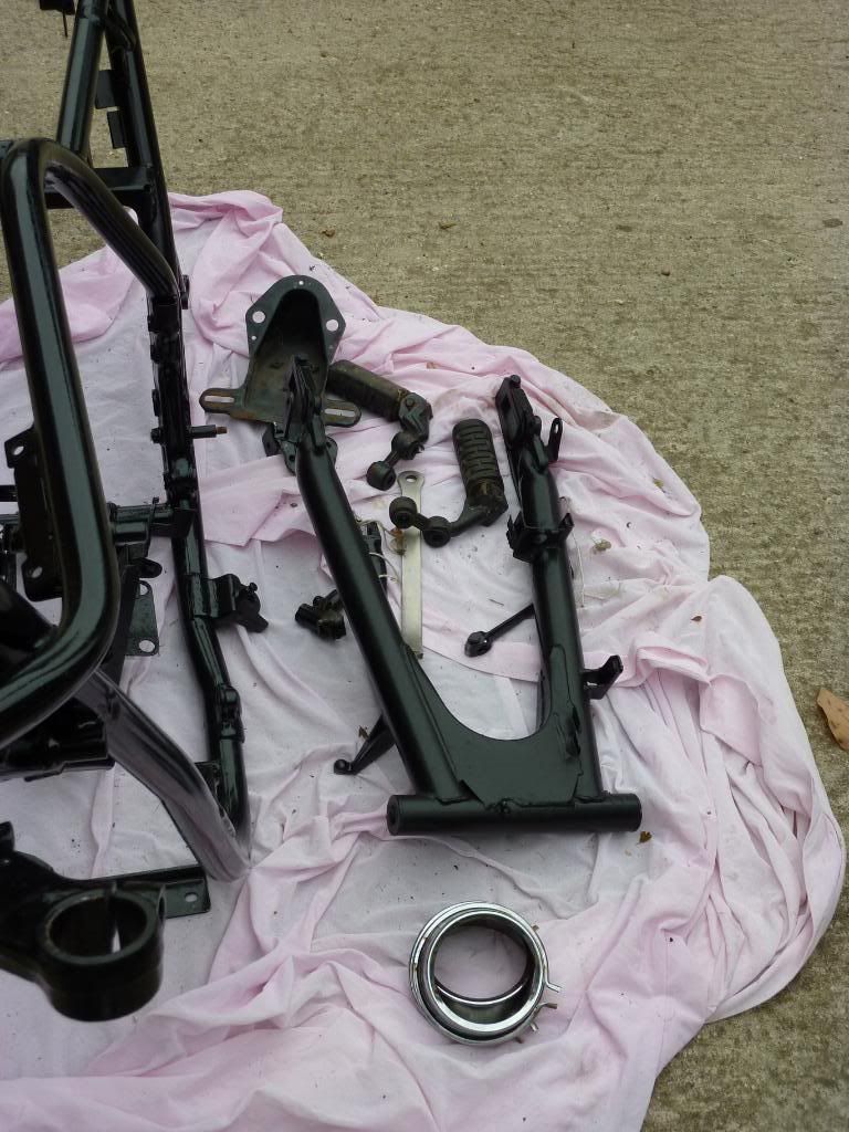

Well here are a few photos of the Z900 BunnyZ and I recently bought (thanks Mike). As you can see it came already in boxes so today we went through the boxes and did a partial dry build of parts to see what we've got, whats good, what needs work and whats missing - ooh err. We used my A4 for reference.
The eagle eyed amongst you will notice it is not a Z900 front end but a Z1. So because of that we're going to a Z1 style like restore..
Still debating brown/orange or green/yellow - the latter is my preference but Pauls got the tank and is organising the paint.
He also has all the bits for paint, zinc, chrome etc.
Mikey - a lot of work for you I'm afraid - expect a big box in the post soon.
I've pulled the forks apart as the stanchions (sp?) are very pitted - new ones or good serviceable ones needed - any offers ??
Engine covers off for dechrome (Yuck) and polish. i'll pull the engine apart, fix what needs doing and rebuild. It'll be done black a la Z1. It'll be mechanically sound but not to MaineKz exacting cosmetic standards.
I'll post photos of the engine strip/rebuild and Paul can post photos of the cosmetics.
Will be on the blag for parts (took 2 pages of notes today :( ) ......
Frame & other paint bits.

Has the frame/swinger already been painted/powdercoated :?

#6 PostAuthor: chrisu » Sat Aug 15, 2009 8:03 pm
Ginger Bear wrote:Looks like that'll keep you busy!
Painted yes but we will be doing it again.

#7 PostAuthor: Ginger Bear » Sat Aug 15, 2009 9:18 pm
Is it gonna be paint or powdercoated?

#8 PostAuthor: bunnysZ » Sun Aug 16, 2009 7:49 am
frame will be powdercoated.
tank orange/brown :wink:
or could do one side yellow/green other side orange/brown.
