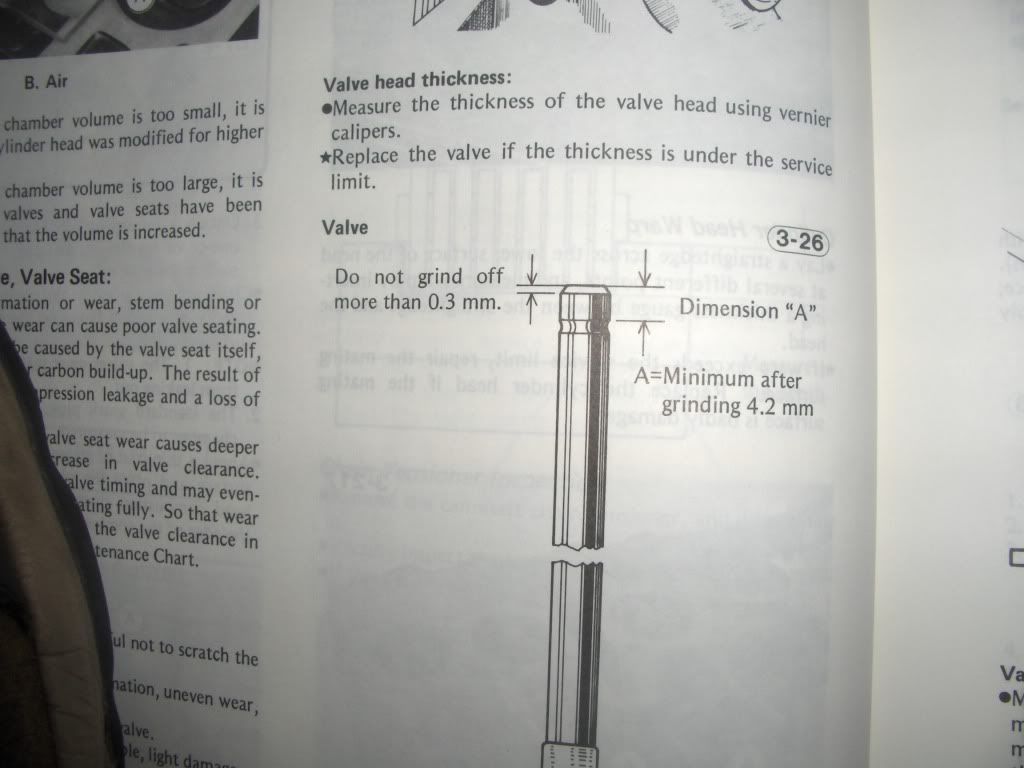

#83 PostAuthor: big green bus » Mon May 11, 2009 6:54 pm
the KAWASAKI manual says you can
[img][img]http://i150.photobucket.com/albums/s82/worringtonminge/stuff030.jpg[/img]
[/img]Image
if you cannot read this it says (in the kawasaki manual) do not take off more than .3 off. i have aready done this on another motor with no problems, but the choice is yours

#84 PostAuthor: Pigford » Mon May 11, 2009 6:59 pm
BGB... is that for UNDER BUCKET shims :?:

#85 PostAuthor: Ginger Bear » Mon May 11, 2009 7:08 pm
Thanks for that BGB, I don't want to sound 'dis-respectful', but does the manual you have cover the later GPz1100A models which have the under bucket shim's :?
If it does, then I'm a happy bunny......... er, I mean Bear :bear

#86 PostAuthor: big green bus » Mon May 11, 2009 7:12 pm
for both mate, i was told by an engine tuner some years ago. i still own the bike and have had no prob's with the valves (but i may have been just lucky) it is your choice but don't do it if you are not sure. going under a 200 shim is not recommended as they can shatter if on top and let the collets move if under.

#87 PostAuthor: Ginger Bear » Mon May 11, 2009 7:36 pm
Thanks BGB,
I suppose as long as the collets aren't higher than whats left of the stem, then it should be fine I suppose.

#89 PostAuthor: zed1015 » Tue May 12, 2009 5:11 pm
Ginger Bear wrote:Thanks BGB,
If you have to grind the valve stem more than the recommended maximum its possible to pinch a bit off the tops of the collets to get the collet to shim/bucket clearance back using a spare valve and retainer as a jig and access to a lathe. The collets do cut easily using a carbide tip. I had to do this on my race head due to the non standard valves that are fitted, but that's another story :roll:. Also if you go down to your local engine reconditioners you should be able to get valve seats for around a tenner each. just take an old one for them to match up. It's not that hard to replace them (can tell you how if you really want :wink: )but you will need proper seat cutting gear (neway etc) to finish off so it might be cheaper to take it to a shop if you aren't already rigged up for this sort of job. P.s. DON'T GRIND SHIMS.
