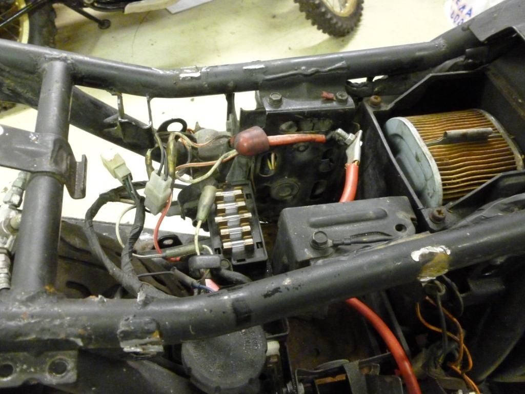

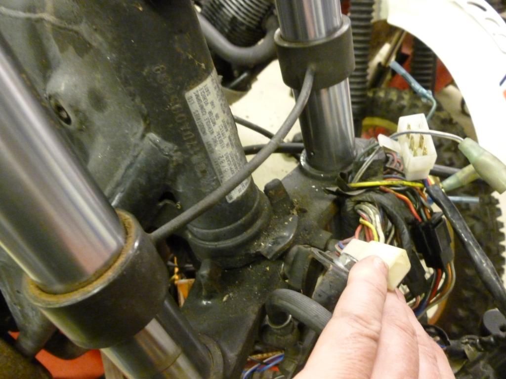

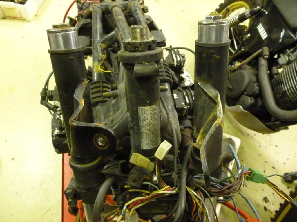

With the electrics now more or less sorted or at least working i have moved up front removing the stock headlamp brackets
Revealing perfect tubes :) As part of the(more) streamlined look, simple headlamp brackets will be fitted. The air balance tube will be removed and the holes in the legs plugged. The other fork leg will require drilling tap and an air valve. Lock stop looks to have taken a hit so will have to have a close look at that lower clamp when it comes apart. New seals are on the way, i will need dust covers

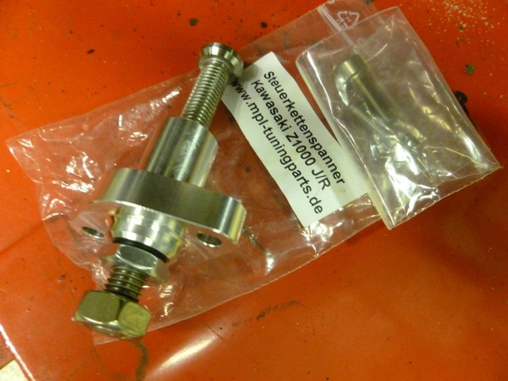

The first of the ordered in parts has arrived with a bargain manual camchain adjuster from MPL :bla

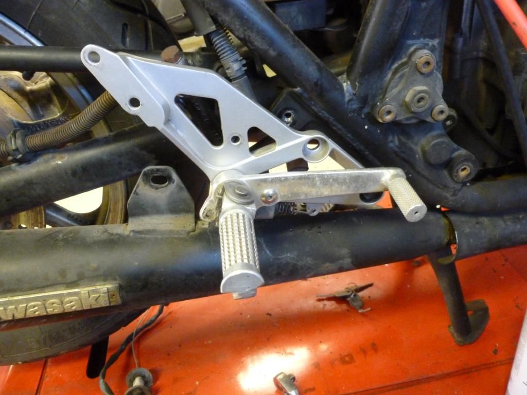

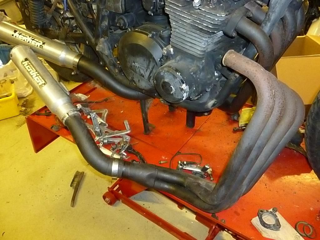

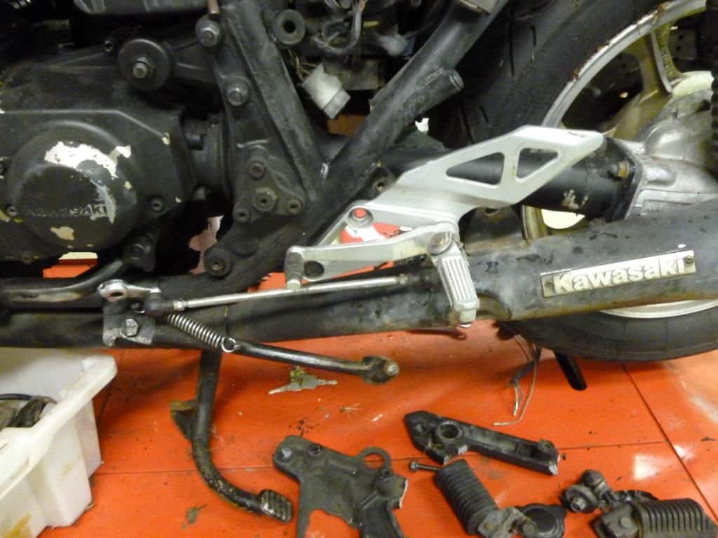

Some messing around with various rearsets i found these water boiler GSXR ones matched the angle of the frame. Unfortunatly i feel they move the pegs too far back in fact 26cm further back than the lazy stock pegs

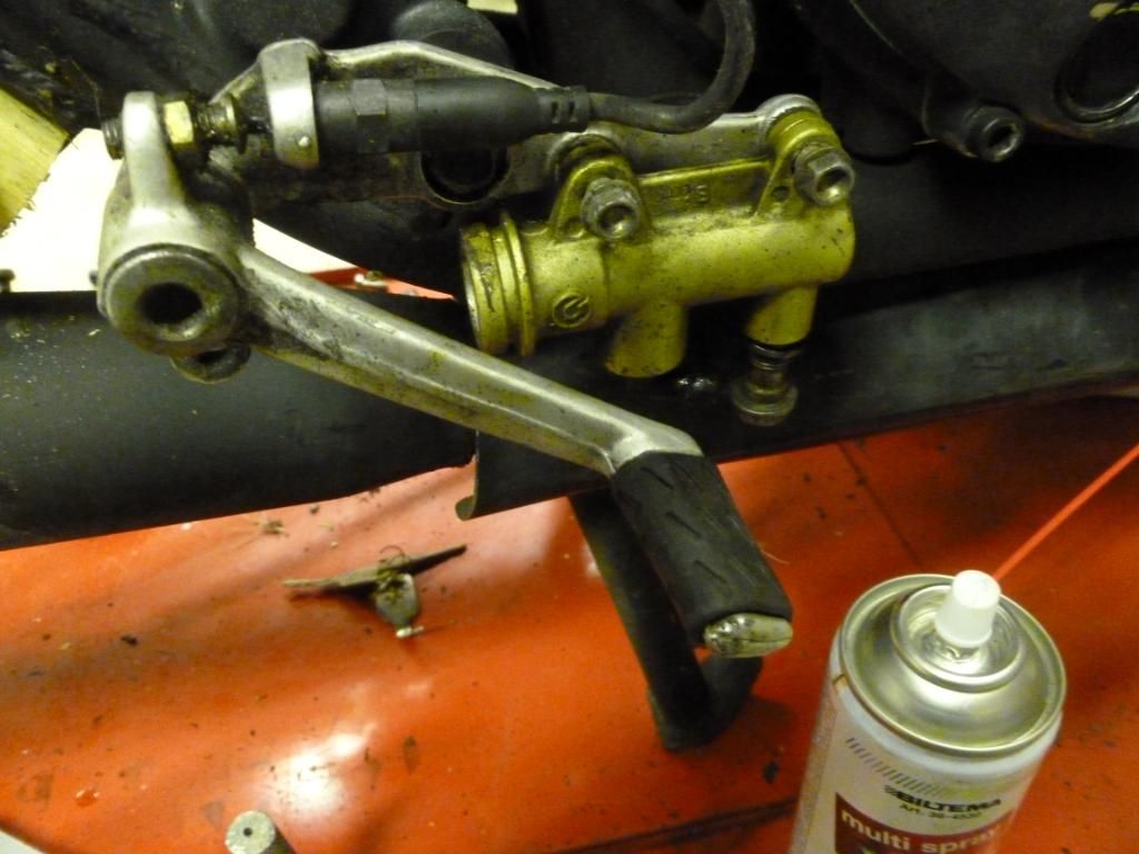

Some more digging and a found the 916 brake mastercylinder which looks pretty cool. I hope its up to pumping the Zeds caliper :?:

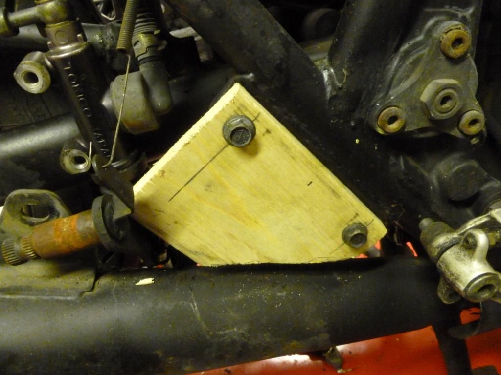

and some wood to make templates for the hangers cheaper and more forgiving than wasting alloy plate :) im aiming for 16-17cm further back than stock. i think i really need a 4-1 in place before finalizing the peg placement. Anyone got one for sale :wink:

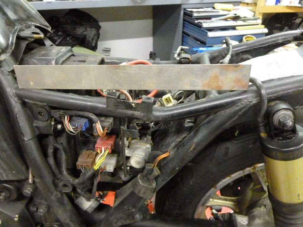

Moving on With a couple of spare hours this afternoon i got the hacksaw out and removed some of the original seat mount brackets. To clear the way to fabricate the seat/tailunit.
The seat rails are probably going to need tweeking upwards as they sit very low compared with a J or GPZ
Parts :| as usual slow things down while you have to wait, but its all part of the process :cry: Good to know things are in transit......

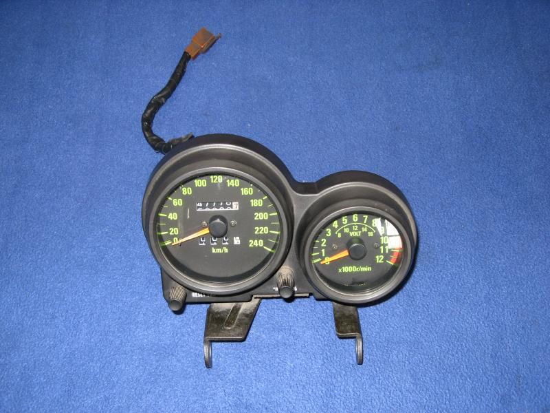

UT clocks
and the Kerker i won on ebay last night :D $125 + shipping :wink: Instant street cred even for a Septic

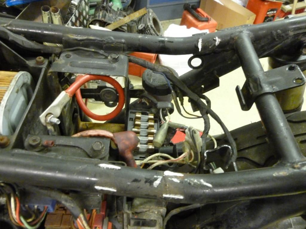

#35 PostAuthor: Rich » Sun Nov 25, 2012 8:22 am
rear M/c is upside down in your pics,
Rich
Mr Puffin
Posts: 284
Joined: 15th Jun 2011
Location: Norway
#36 PostAuthor: Mr Puffin » Sat Dec 01, 2012 8:56 pm
Rich wrote:rear M/c is upside down in your pics,
makes absolutely no differance Rich, the m/c will function no matter how it is placed as long as the resevoir is placed higher and the system is bled :wink: The main point here being keeping it clean.

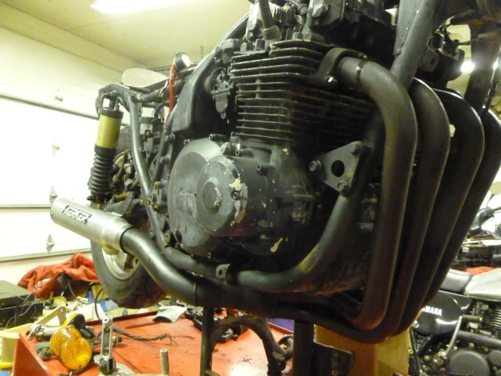

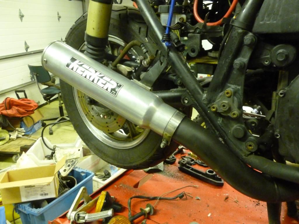

I\m looking at Christmas before the kerker arrives from the US :| So i have robbed the one off my J just to help get the footrests placed. One thing that is very obvious :?? The swingarm pivot is further back on the septic (compared with a j ) so the link pipe is going to need a little work, so im stuck anyway as i dont want to chop this one :twisted:
The Kerker does look cool though :twisted:

The pipe is here :shock: Super Fast shipping, a new record perhaps and straight through customs without any value tax :D

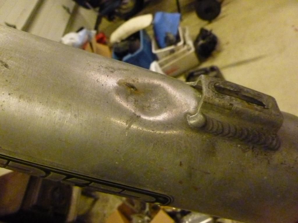

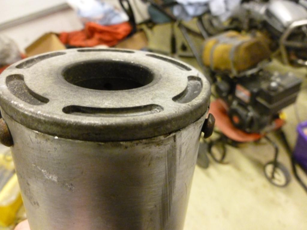

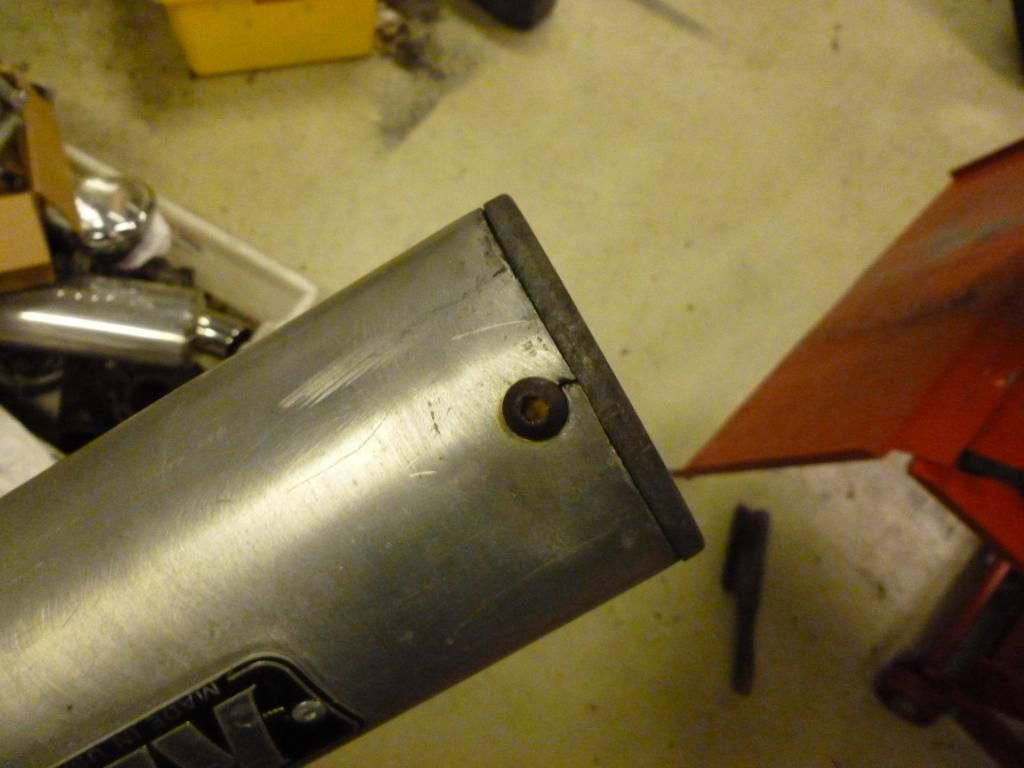

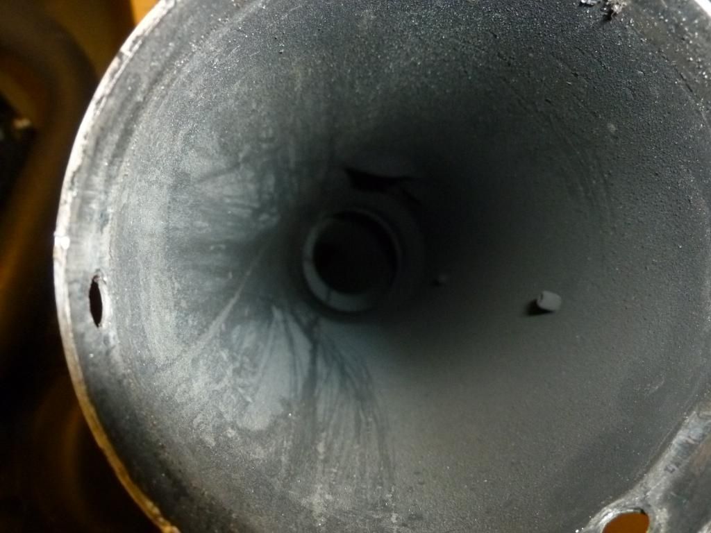

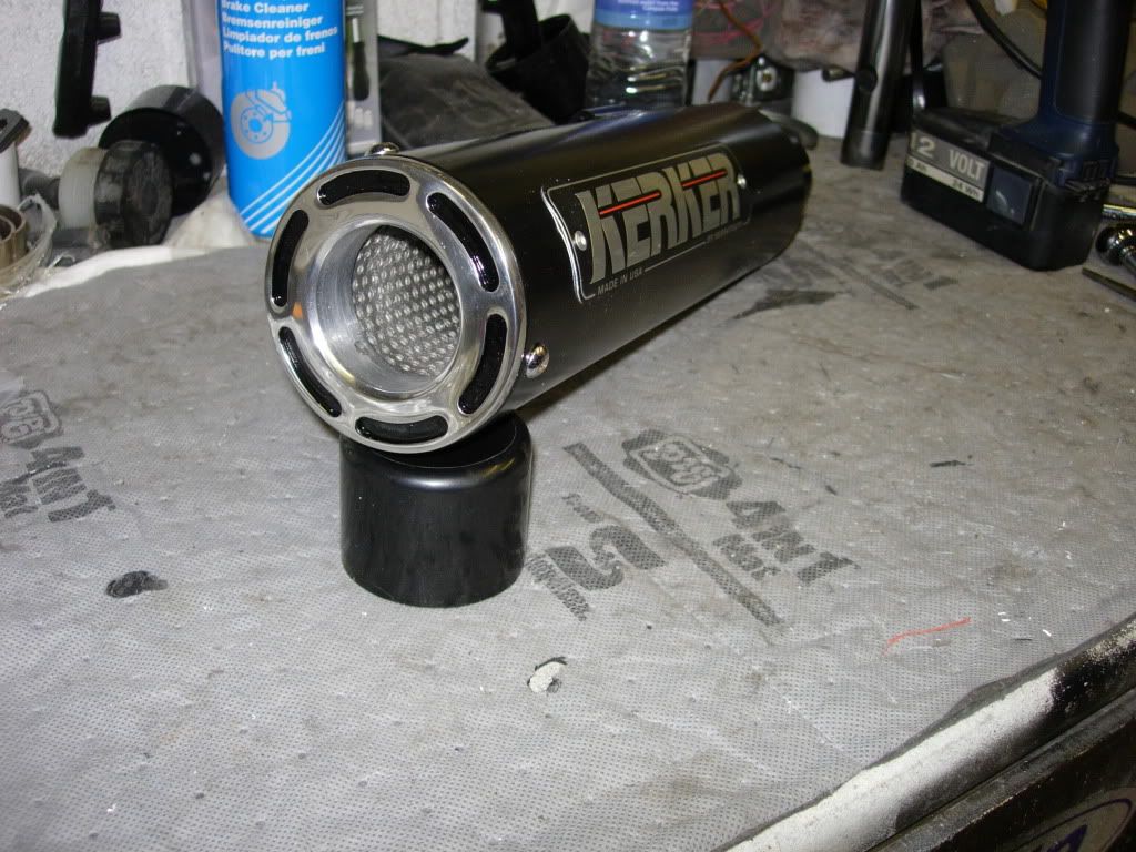

The Headers are in real good shape with only some light rust + 1 small dent. The can is split at the end cap bolt hole and has obviously had a hard knock at some point
This dent is hopefully out of sight
The Baffle is missing too so im thinking cut the can down open up the outlet and make/fit a larger baffle like GB did in one of his builds.
Fingers crossed Hansen will round with the Boses for the frame/footrest mounts + tube for the seat rails at the weekend so i can get moving. Would be nice to have the frame back from paint before Christmas :wink:

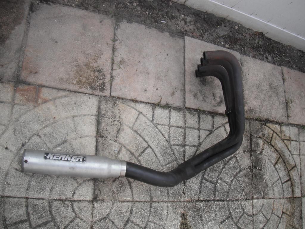

#39 PostAuthor: Ginger Bear » Thu Dec 06, 2012 7:56 pm
There ya go Mr Puffin.......
..... A bit of inspiration for you!
# 104

#40 PostAuthor: Mr Puffin » Thu Dec 06, 2012 8:37 pm
Ginger Bear wrote:There ya go Mr Puffin.......
Thanks GB i was just about to PM you :D found your thread but the can surgery was missing... :| Ihad forgot you had gone Black with the can :fro The larger outlet certainly looks Good, do you remember the perforated tube size :?:
