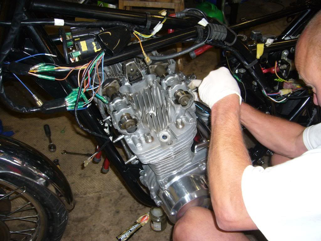

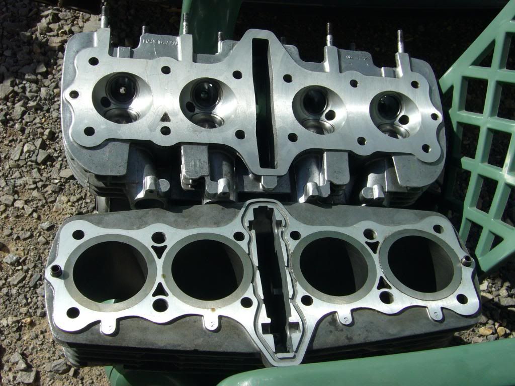

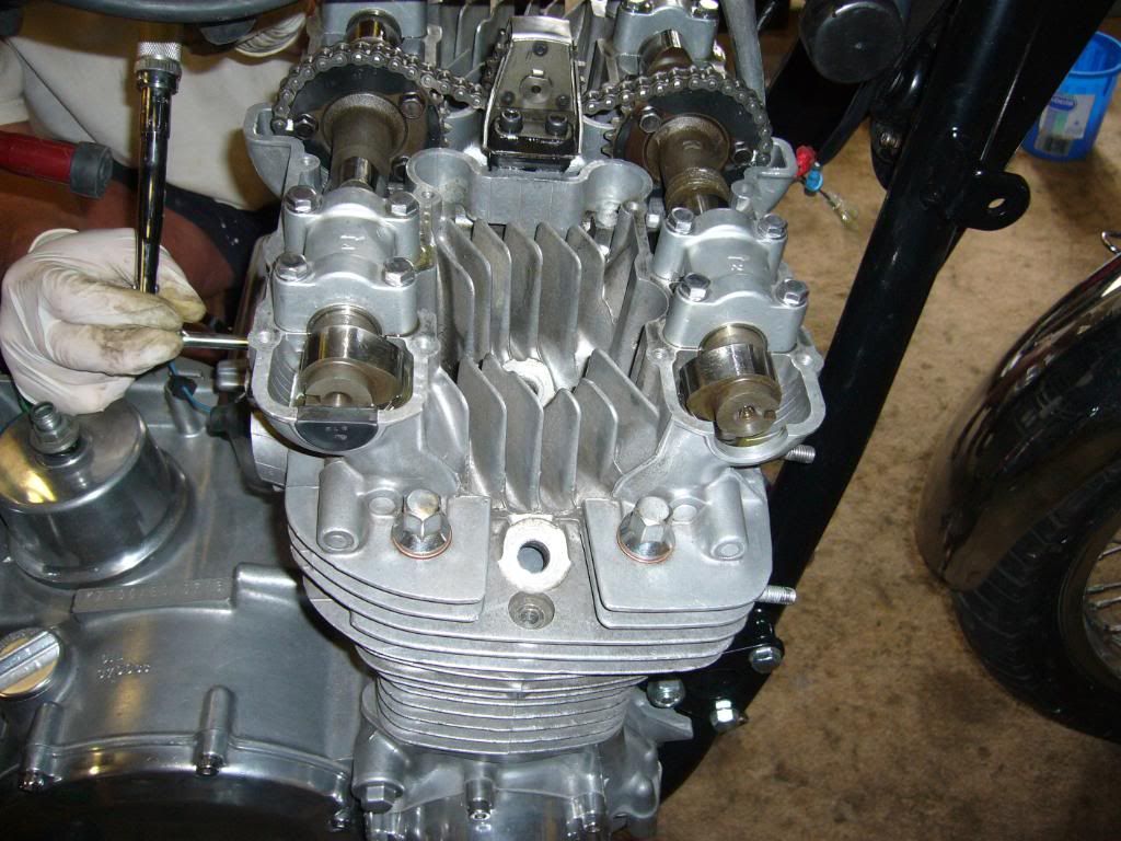

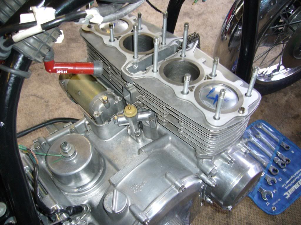

got the block & head back, block skimmed, barrels have been honed ready for new piston rings, the head also skimmed plus the valve seats recut ready for new valves, the original valves that came out were a combination of z900 & z1000 fixed with square & round collets but not with the right shaped collets on the right valves, the motor must have been built by the sun dance kid
ports given a smooth & pollish
valves in & shimmed up on the bench ready for fixing [thanks to pj & duane for help with the shims]
barrels now on, used the down pipe & cable tie method to clamp the piston rings
head now on & timed up with a little help from delboy

Alan, I don't want to cause you alarm, but when I rebuilt my GPz engine (1170), both the head & barrels had been skimmed by previous owners, the head was skimmed again by Arnetts. I had massive oil leaks from between the head & barrels, the cause was very simple. I had not trimmed the length of the dowels that sit on either side of the block/head, & they stopped the head sealing properly on the barrels. If you've not trimmed yours I would consider whipping the head back off now & doing it, that way you should still be able to re-use the head gasket, it'll be a fairly easy job if you haven't fitted the pipes/carbs yet.

hi steve thanks for the advice, i was aware of the issue of the dowels following a visit to yours a little while ago, it was fresh in mind and was the first thing i checked, clearance was fine before the head gasket went on, so hopefully no problems, im not to far away from attempting to fire up the old girl, it will be clenched bum time im sure

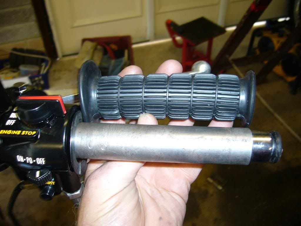

i thought i would tackle a five minute job last night, just need to fix the handle bar switch gear plus throttle slide & grips, got some new z9 bars which are pre drilled to take the switch gear
only one problem either the bars are to long or the grips are to short [is it me]
job sorted, 10mm cut of the bars, lucky ive got one arm longer than the other

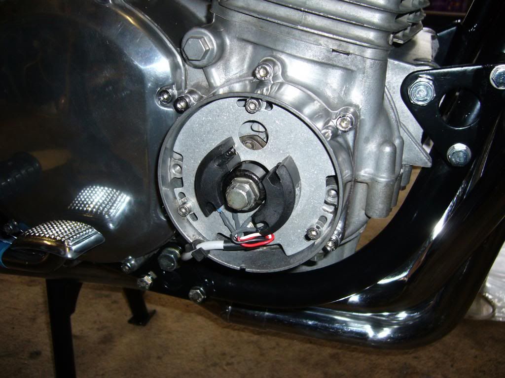

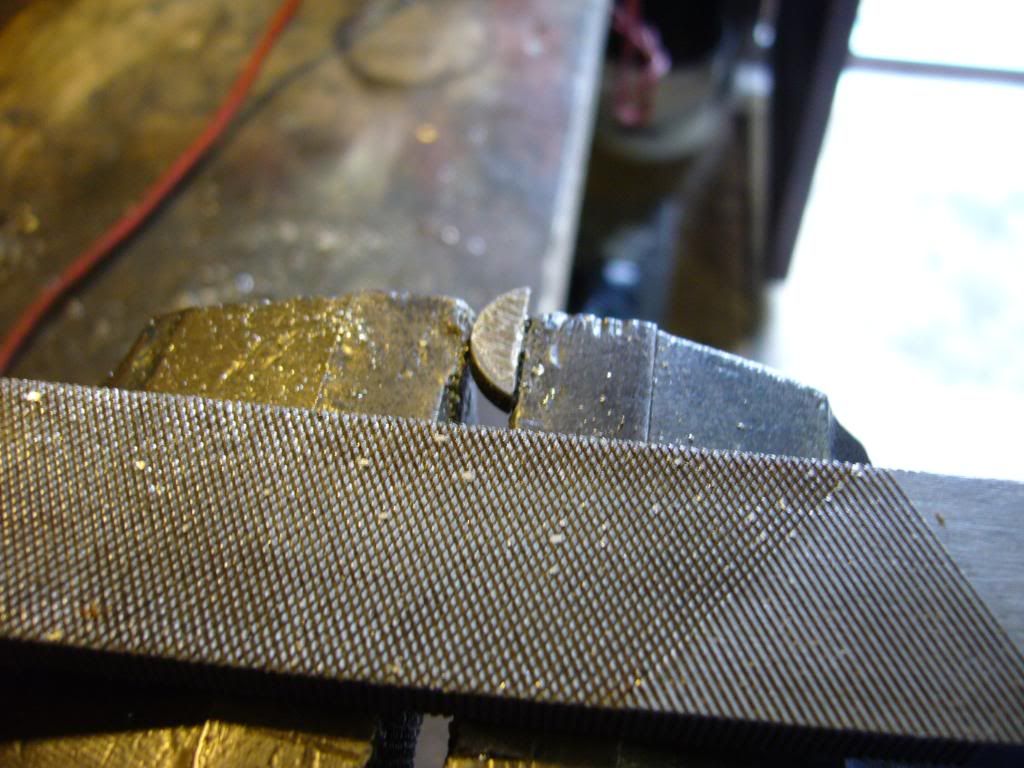

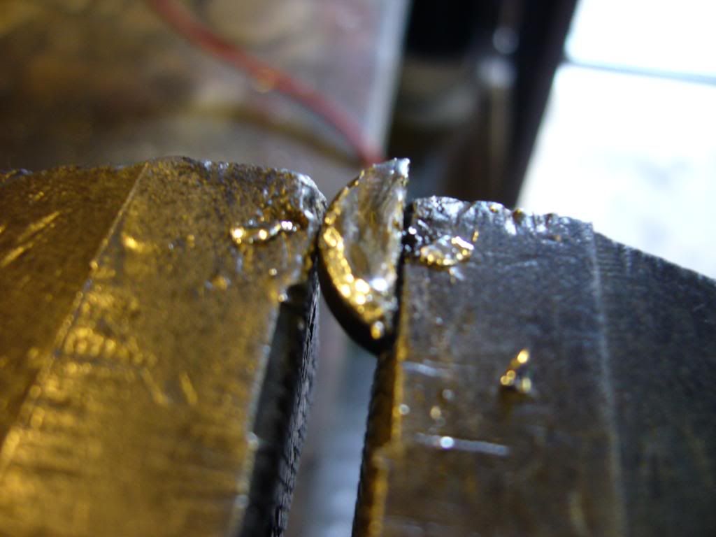

time to put rotor on, the new woodruff key was not a snug fit in the keyway due to a little keyway ware,this made it almost impossible to locate the rotor without the key moving, after asking various pals for the best way to over come the problem,the best suggestion was to tin the woodruff key with solder [not one that i would have thought of but it worked a treat]
solder applied
solder filed down
woodruff key in and solid ready for the rotor
thought this might be of interest to tag on the thread, any one else tried this :?:

Excellant work Mirror Man, not heard of that fix before.

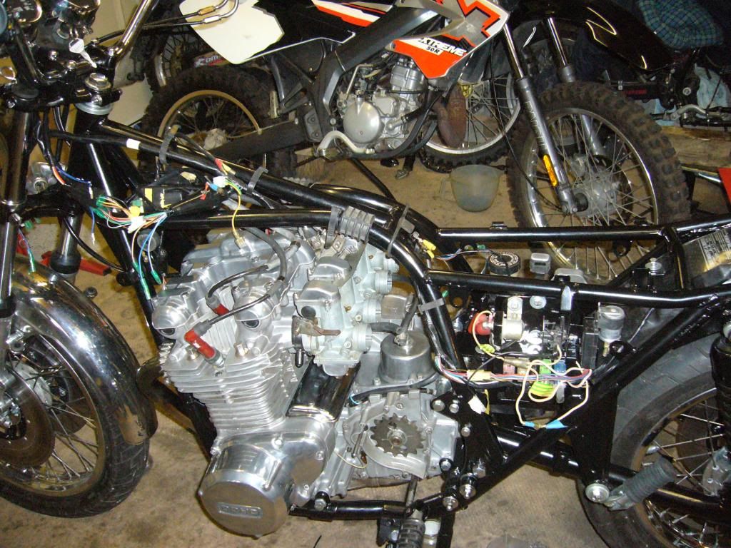

i've had a good weekend and made some progress
got the exhaust on, carbs on, just give um a strip and clean, there fitted with 115 main jets, not sure how there gona run, we'll see how it goes
dyna s ignition in
now just need to get the tank on add fuel & fire up the beast
the big moment arrived clenched both cheeks and the old girl fired up on the button, no nasty noises, no smoke, and sounds sweet, just need to get the strobe on it in the week, plus the carbs probably need a good balance [that's beyond me] i didn't take any pics of the event but did film it on the camera [no idea how to load it on here] ran the motor for 7 or 8 minutes then noticed the rubber cam end plugs were sucking in, this turned out to be because i used a gasket cement to seal & not a silicon sealer [plank] cam end plugs re fitted last night & left to stand, fired up the old girl today and all seems well, all in all so far so good but it's early days. still got plenty of missing pieces of the jigsaw to work on

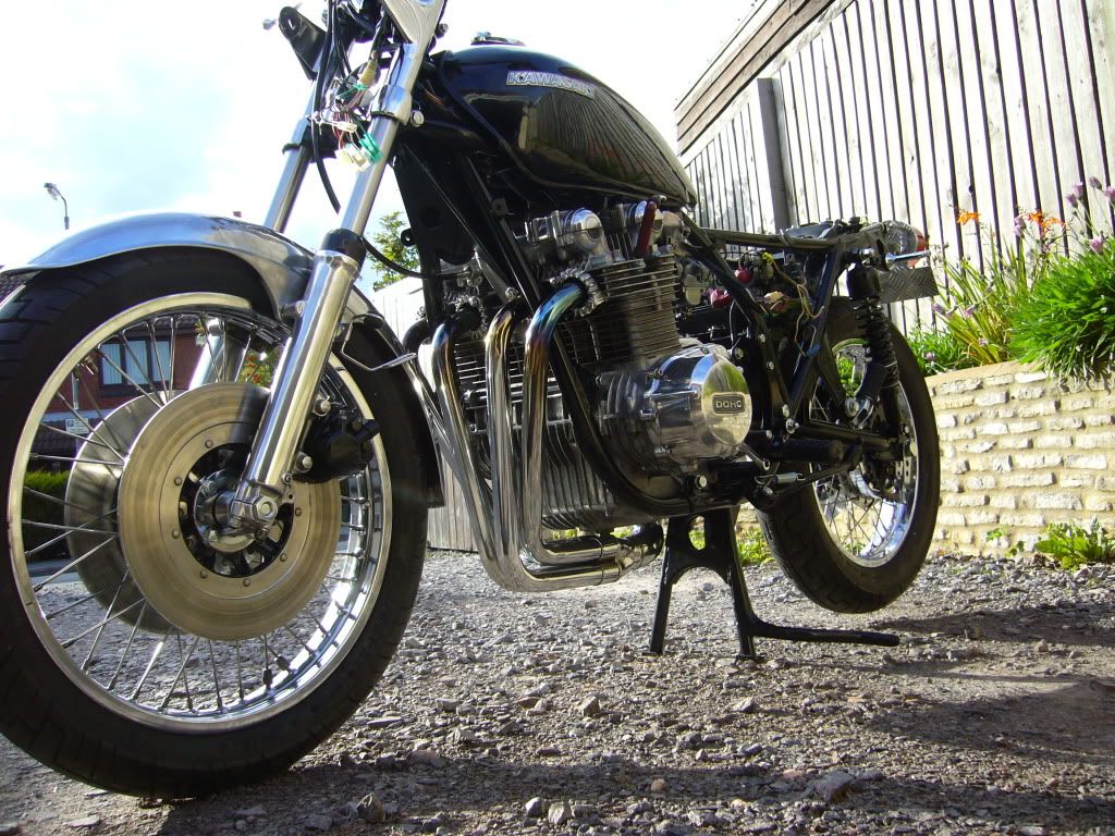

#41 PostAuthor: mirror man » Mon Aug 15, 2011 6:34 am
sorry chaps unable to load the video ?, tried three different players
just wont have it, so back on with the build

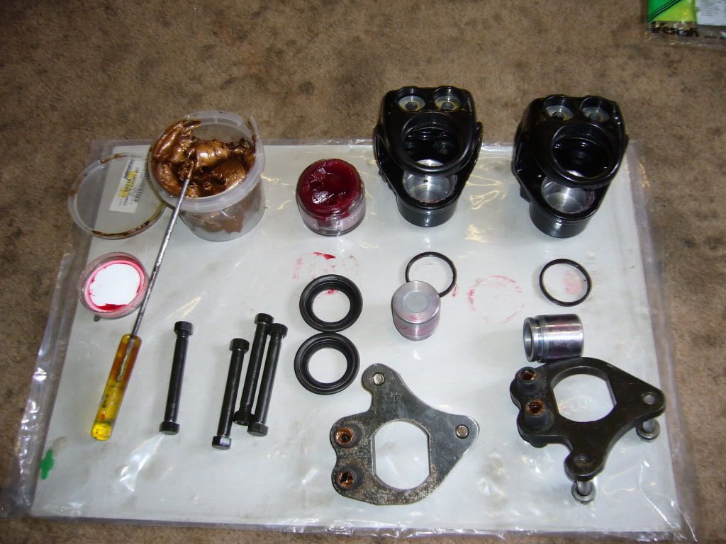

brake calipers ready for rebuild with new seals
now rebuilt and back on and some pics in the sun

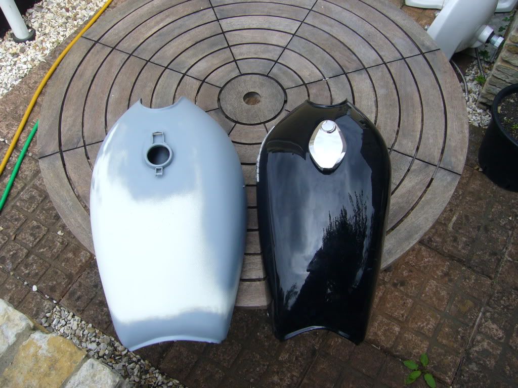

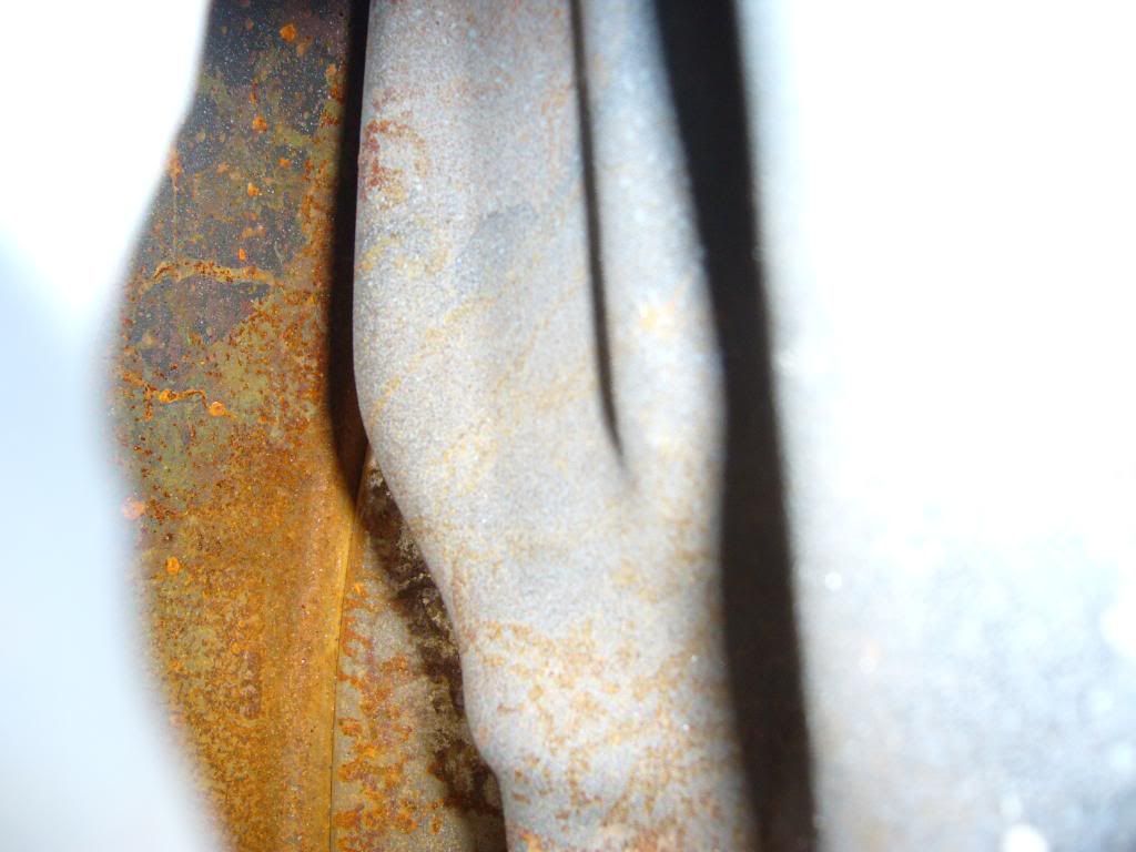

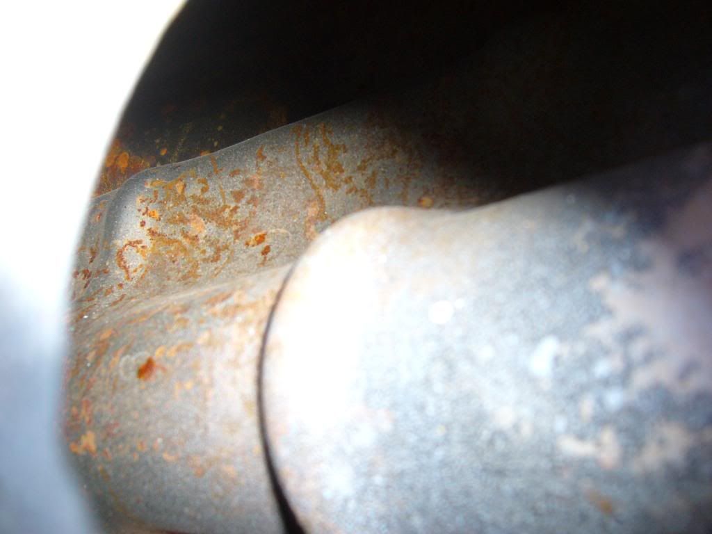

next job to tackel is the fuel tank which has been left on the back burner,the black tank which came with the bike seems to be off a limited ? have now got a white tank from an a2 [can you spot the difference] the replacement tank has some light surface rust inside which needs a sort out

some pics of rust inside tank

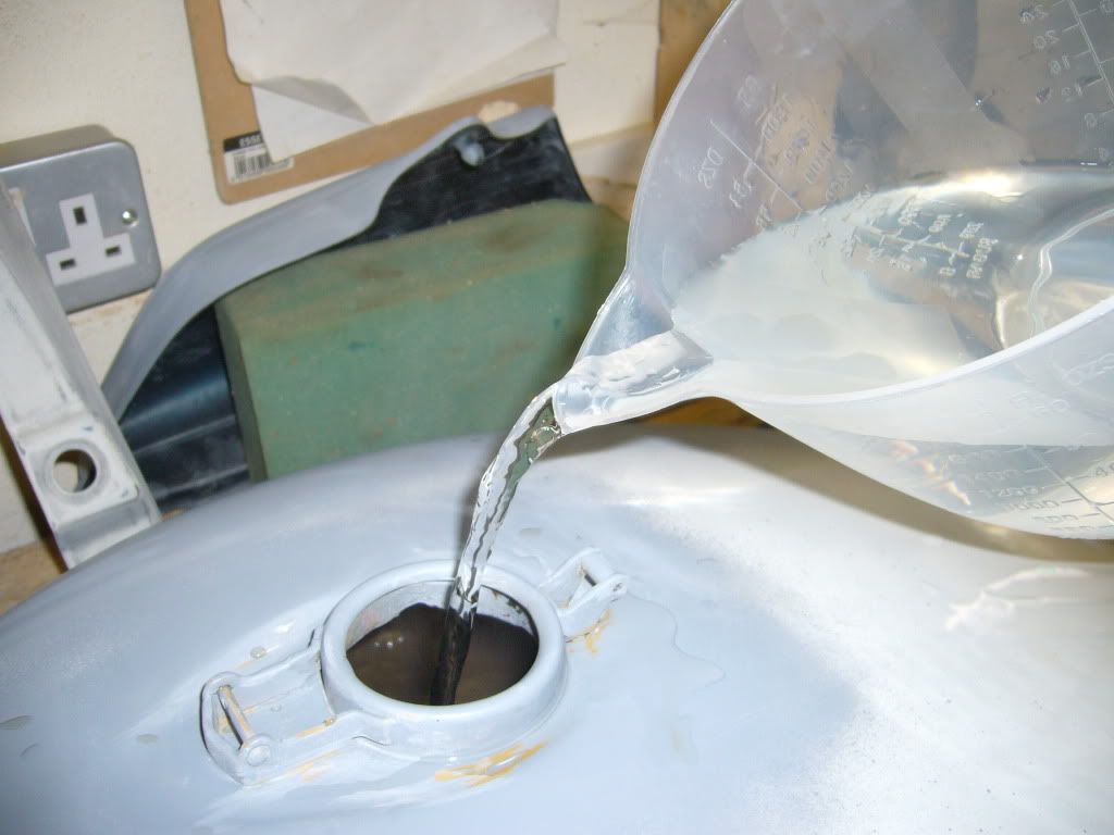

blanked off bottom of tank filled with water to test for leaks and left over night to stand, all is good no problems, i have opted to to treat tank with biorust

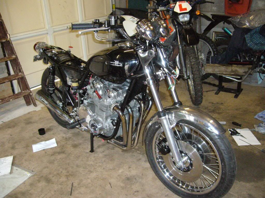

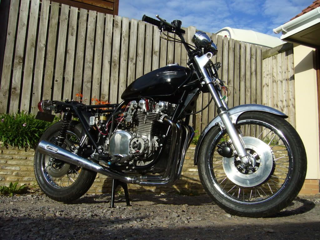

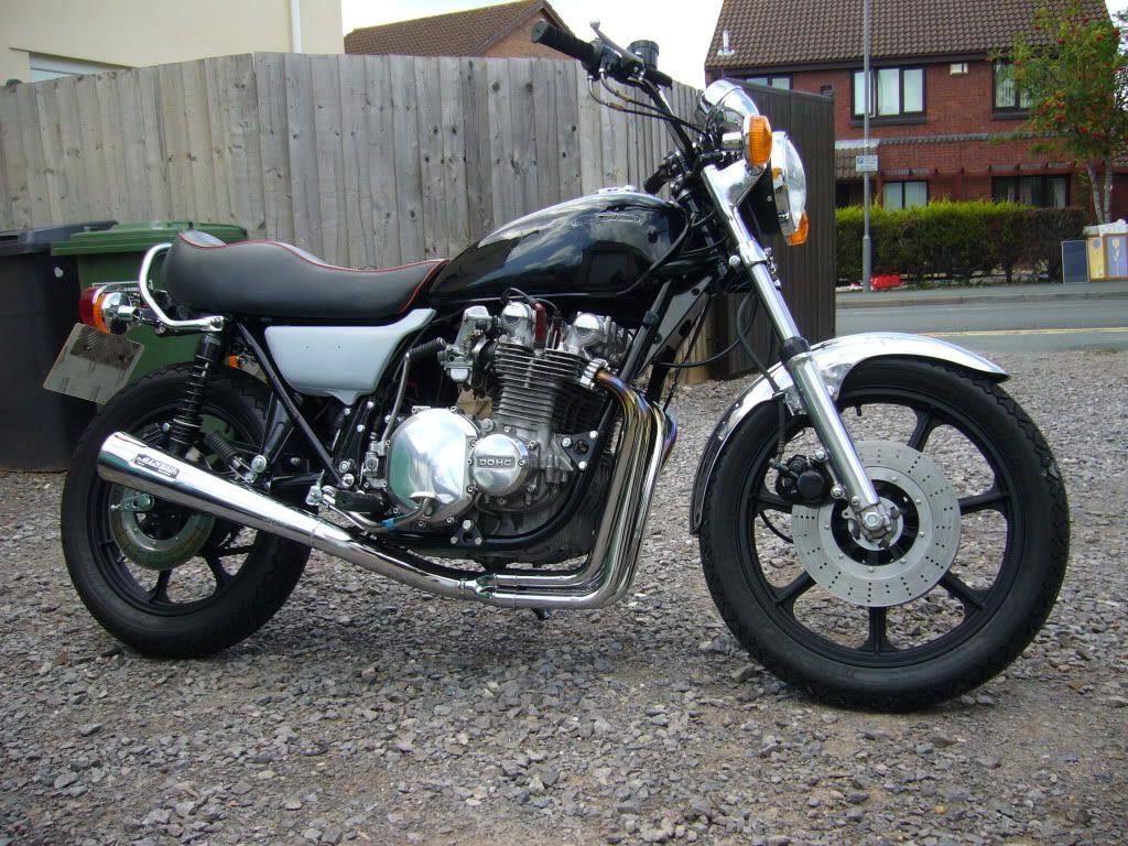

ali winter wheels now on after a fresh coat of matt black paint, also just purchased some hel black braided brake hoses which should be a standard fit for an a2 :?: rear & top front hoses ok, both front bottom hoses 230mm to long, have sent back to hel to be reduced see pics yuk
fitted rear brake hose and gave it a bleed, now got one brake, put the seat on & fitted the head light [not wired up yet] then took it round the block half a dozen times for my first z test, a bit of a ginger ride it felt a little uncertain , clocked up a few miles pop'ed back to the garage for a check over, head stock and front wheel loose :ooops , a quick tighten and round the block again a lot better this time with things done up.
all in all not to bad, a few back fires through the carbs at first but seemed to get better, the rear brake is fairy shite i guess that normal, also the clutch judders when it bites will this go when it beds in :?:
not sure about the speedo reading :?: bikes running with 15 & 33 tooth sprockets, 4 thou in 5th gear & speedo was showing 70mph :?: still got quite a few jobs to sort but it's coming along, a front brake some lights & an mot would be nice :D :D :D :D

#45 PostAuthor: Pigford » Mon Aug 15, 2011 6:30 pm
Looking Soopa-Doopa :twisted:
If the clutch plates are new - or been standing out of engine for some time, they need soaking in oil before fitting :wink:
