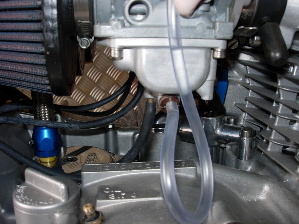

Fuel levels are spot on. I used an old drain plug, drilled & fitted with some clear tube to measure levels, carbs have recently been ultrasonically cleaned.

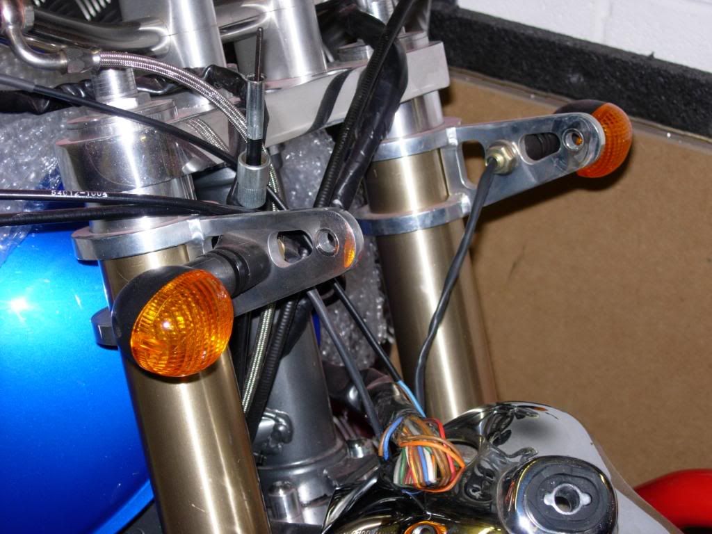

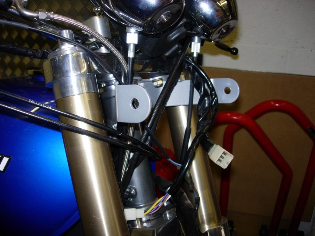

Have done another couple of mods recently. I have removed my beautiful, but bulky headlight brackets.
And fitted a Ltd bracket that bolts to the underside of the top yoke using the clock mounts.
Thanks for the tip Steve R!
Bracket was originally painted black, but I had it powdercoated in silver, something I am not sure about. It may come off during the winter & be chromed.

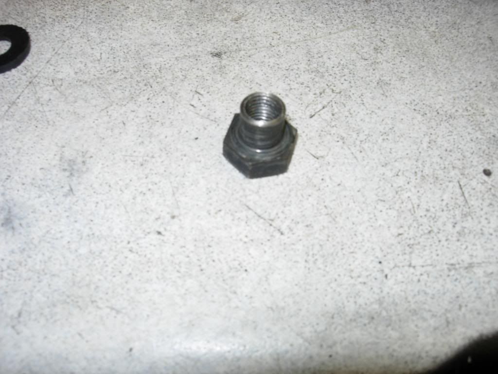

Had some trouble re-fitting the indicators, as the thread was a little short. after a couple of efforts to resolve the problem, I came up with these.
They are M12 bolts, cut down, drilled & tapped to fit the short indicator stems.

In the pic above are you taking a reading for fuel level with engine running on static?
I've been doing mine whilst running and it does appear to make a difference.
Is it running rich all across the range or just at idle.
If 'all across the range' you can lower the dynamic fuel height by a mm to make the fuel level fractionally less accessible to the pilot system in particular but it will effect the whole setup so a little care needed here.
