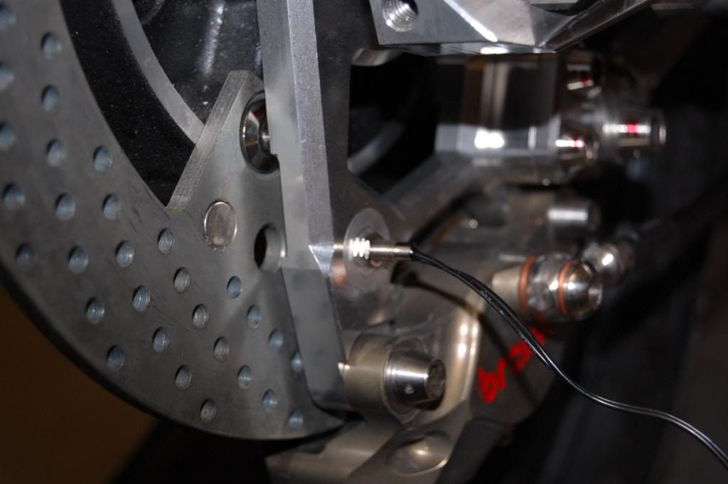

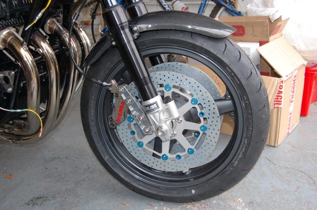

I've been focussing on the wiring this weekend but I started by fitting the front mudguard. Lacking the skills to make my own out of an unsuspecting roadsign, I eventually found one for sale in Japan which is a perfect fit. I went for carbon fibre as the whole front end is modern and the rest of the bike is very black, so I thought it would make a nice contrast. I can always paint it black later but I think it looks OK. I also got the rear wheel speedo sensor sorted. Harris had fitted a bush in the handy hole in the caliper carrier, and I glued 2 rare earth magnets into the 10mm holes in the disc. I tapped a thread in the bush (it was a very fine M3 thread so I had to buy a special tap) and then screwed in the motogadget sensor. I think it looks quite neat. I'll fit some heatshrink over the sensor and cable for protection and then run the cable along torque arm with the brake hose.
I've also fitted all the hydraulic hoses, although I am going wait until the electrics are done before filling with brake fluid. I also want to change the Brembo bleed nipples for stainless ones. I managed to get the length of the simplest hose wrong - I didn't allow for enough front fork extension - but then got the length of the most complex run (the 1.4m clutch hose) spot on. Bizarre.

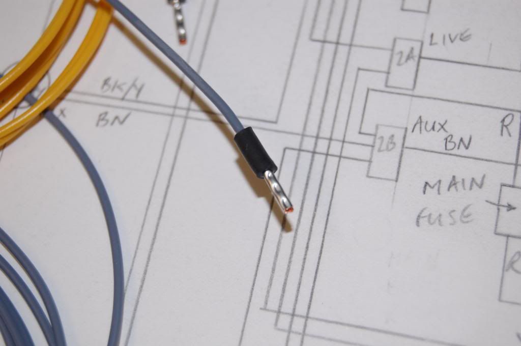

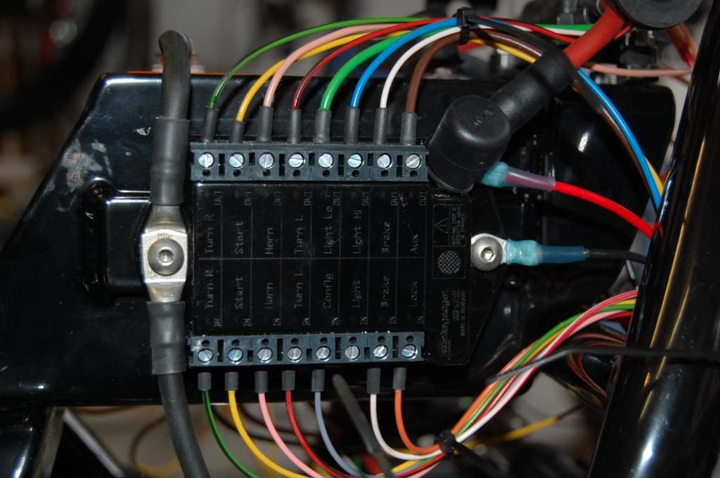

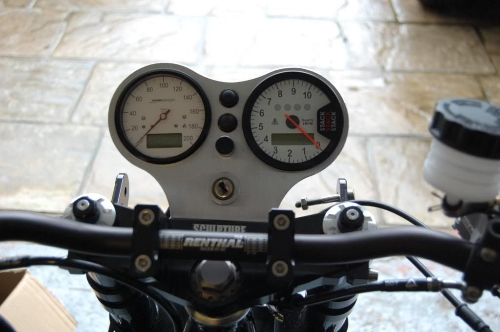

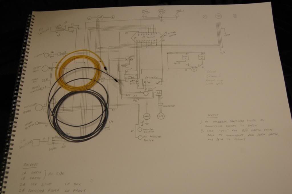

						I've designed a complete wiring harness from scratch as you can see from the sketch. It wasn't that hard, just very time-consuming. The m-unit is a fantastic piece of kit but it works in a slightly odd way - all the control circuits work by connecting to earth - but the end result is a simple loom which only needs small cables to connect to the handlebar controls. The terminals are screw-type so I have used bootlace ferrules with a bit of adhesive heatshrink for strain relief. Couldn't resist fitting the gauges to see how they would look. I haven't tackled the front half of the loom yet, which is going to be a bit painful. The switchgear is new H**** Fireblade from 2004/2005 which is simple and good quality but has far too many wires. I will probably remove the surplus wires and run lighter cables to reduce the bulk of the harness. There's not much room at the front of the bike for running the cables between the tank and frame.

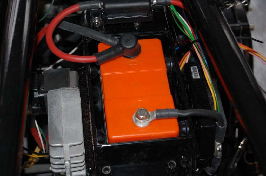

...and lastly I've worked out how to stop the battery rattling around in the box Harris made. I bought some self-adhesive polyurethane hemispherical buttons which are exactly the right height for the gap between battery and box. The battery now slides in with a small amount of pressure, has an air gap for cooling and won't put any strain on the cables.
