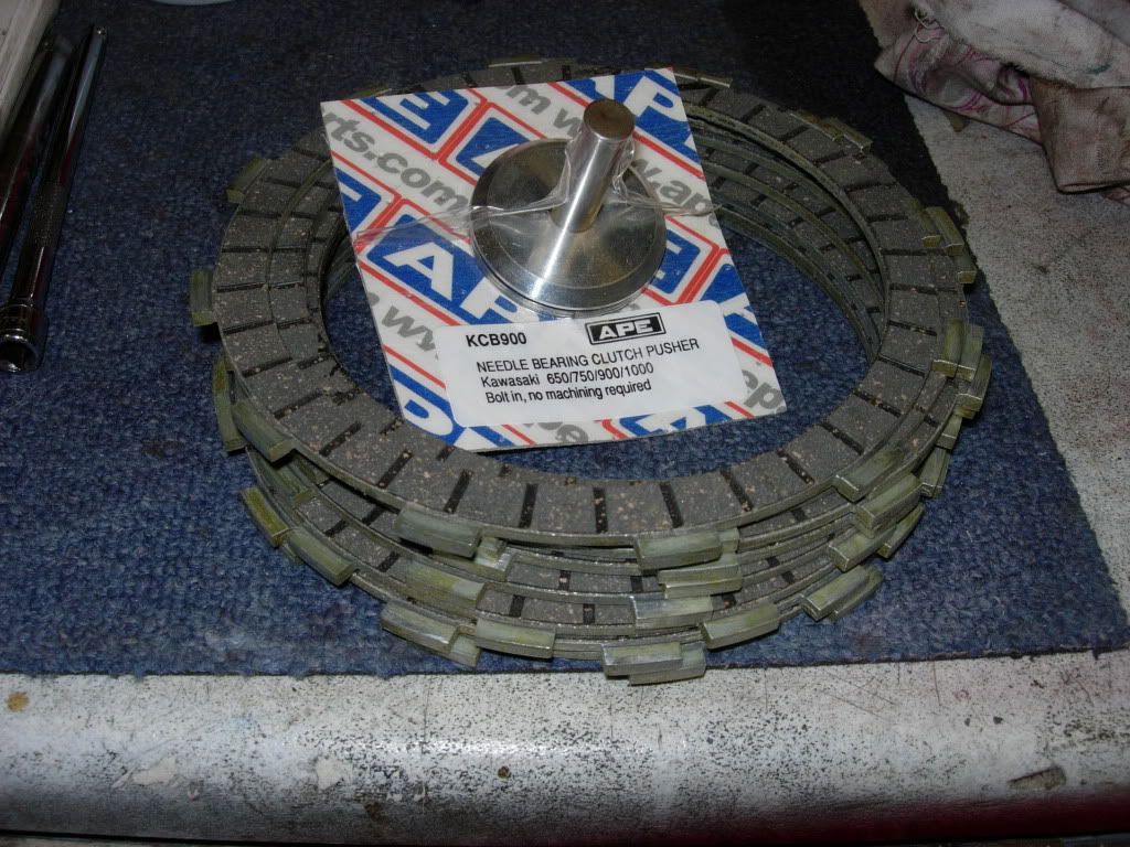

After spending a busy couple of week's getting my 'Snotter' ready for the Ace, I find myself with some time to spend on this little beastie........ At long last!
I picked up a new clutch when I visited Debben. I removed the old one tonight. The plates are well within tolerence, but I will fit the new stuff anyway.
I also measured the springs, which are just within tolerence, but since it's apart I will order a new set from Debben.... In fact just spoke to the wife to be who happens to be passing Ringwood tomorrow...... I love it when a plan comes together :D :D

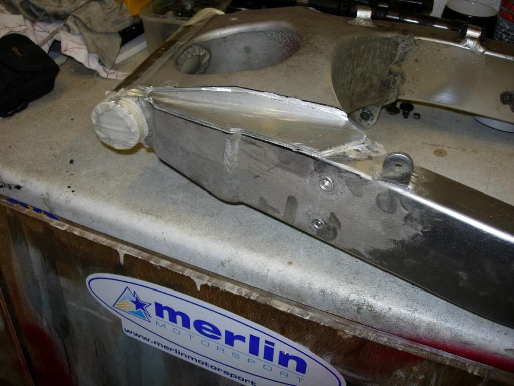

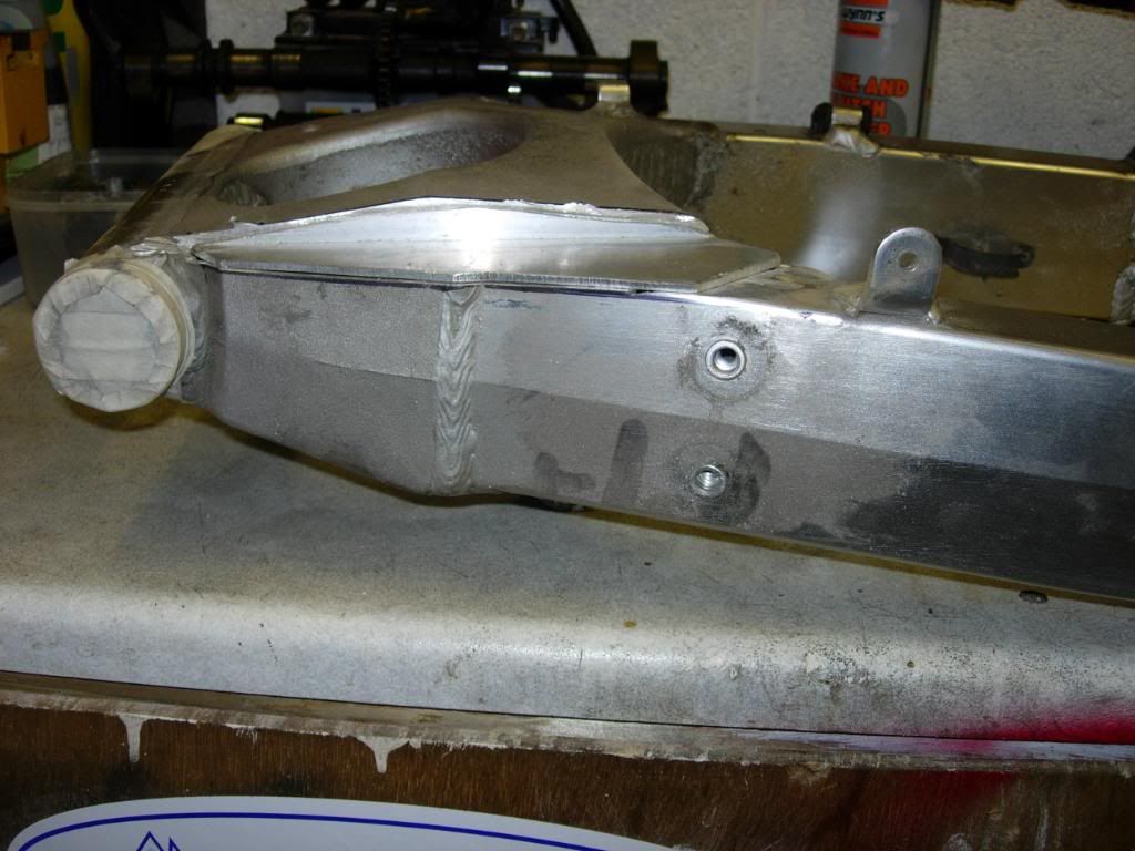

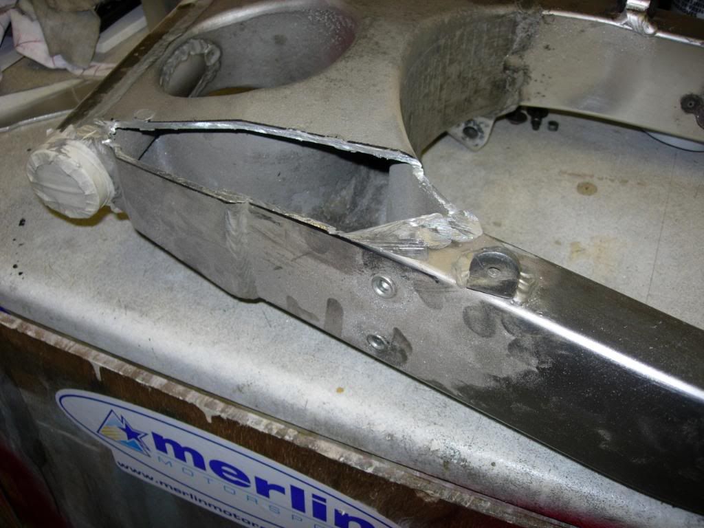

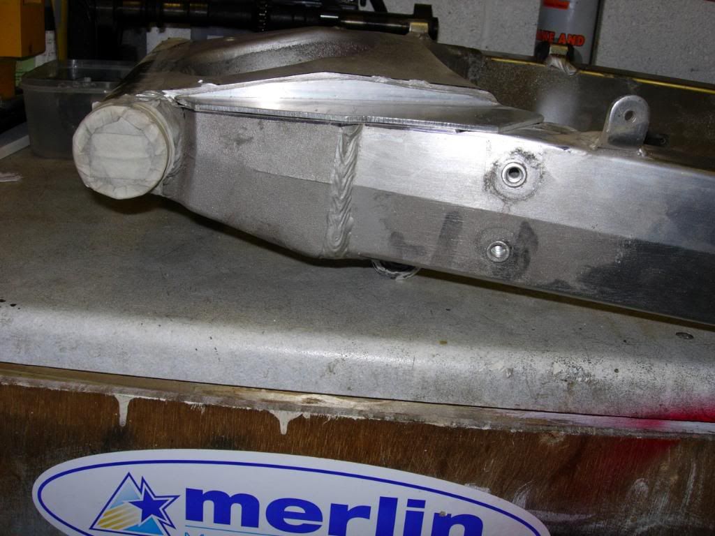

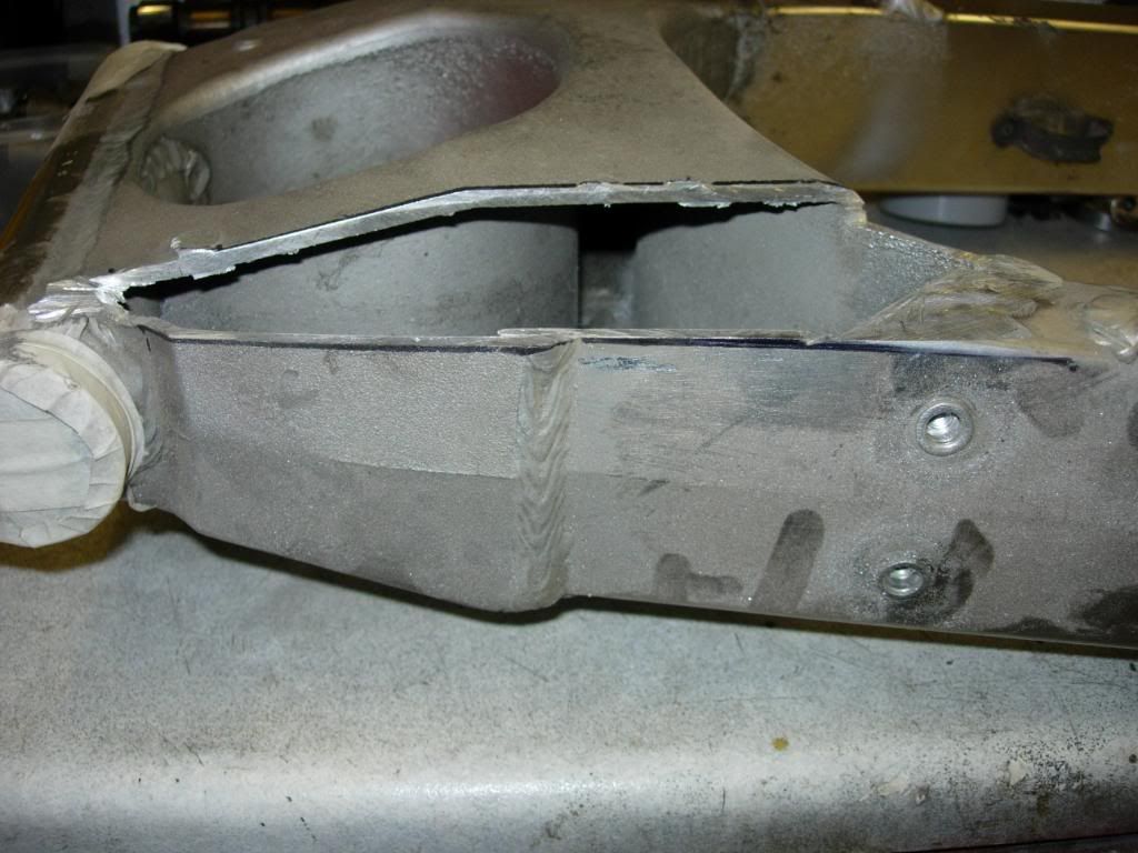

#163 PostAuthor: Ginger Bear » Sat May 16, 2009 7:18 pm
All sprockets fitted & I have managed to raise the ride height a fair bit, but not as much as I would like.
So plan 'B' came into operation this afternoon! I had already sourced another swinging arm, bargain at £15.00
I marked it all up, then got me grinder out :D
I cut a piece of aluminium angle to fill the hole, just need to find someone to weld it all together now.

#164 PostAuthor: Ginger Bear » Mon May 18, 2009 5:15 pm
Dropped my swinger off to be welded this morning at Bowden Classic Motorcycle Engineering, Bristol 0117 9693355. They reckon it will be turned round in under a week at a cost of around £45.00....... I'm happy with that :) I used these guy's a couple of weeks ago to remove a broken stud from my replacement 'snotter' head... £25.00 & turned around in 2 days.
Once the swinger is welded it will be straight to Mikey for some 'Mikey Magic' (another master of the quick turnaround), then I can fit it & hopefully get the arse of my bike where I want it.
