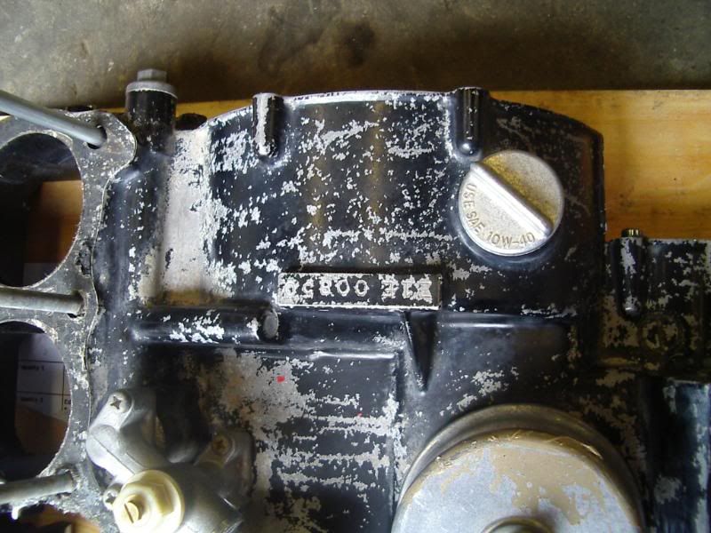

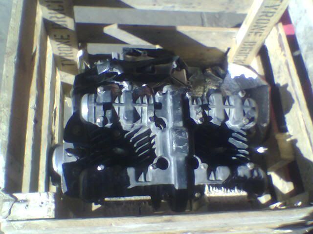

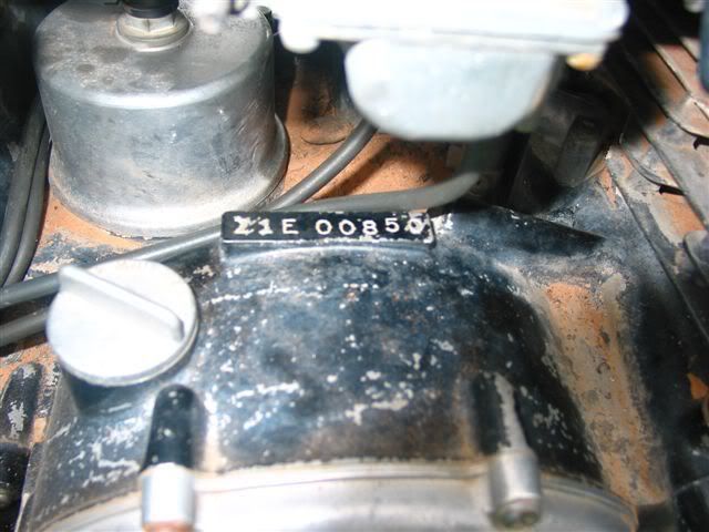

The engine No 850 ,we had removed it early one Sunday morning while a few of us were staying at Davys for the NW200,he has the pics?Arrived with me June 06.
A friend of mine,Richard, brought the engine over.
First job was to check the engine over externally for any damage,not too bad just a broken fin on the outer edge of the barrels,pic to follow.Then degrease and steam clean.Next was to strip engine down,a few horrors were found on the way,mainly due to a cylinderhead change carried out in the distant past.More about that later.
top crankcase with number

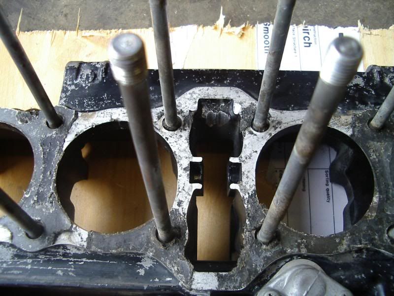

top c/case where chain had been rubbing due to broken guide

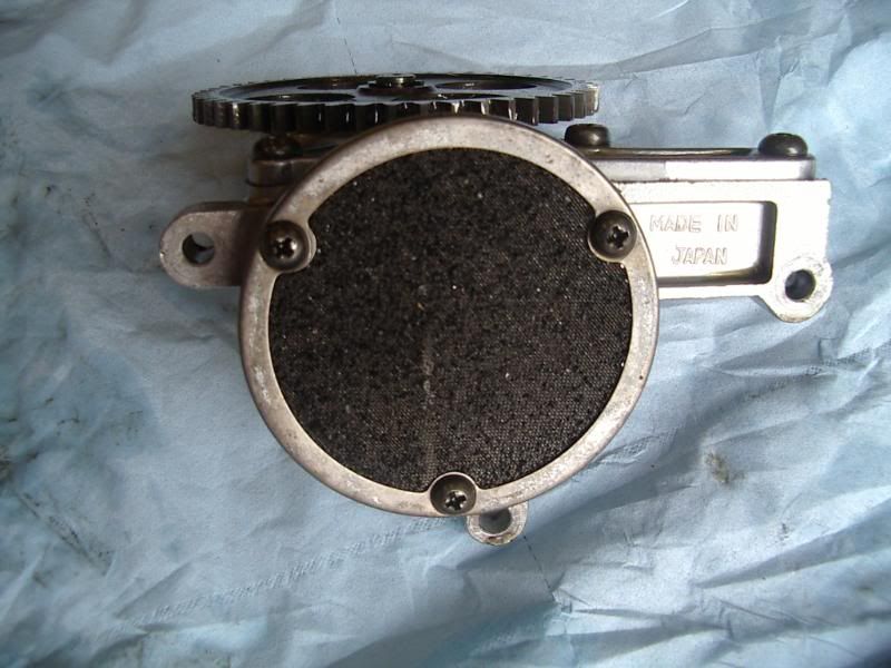

oil pump strainer with lots of bits of rubber bits from camchain wheels

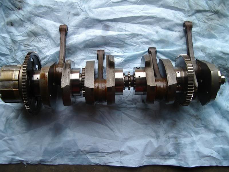

Crankshaft was in very good condition,as were most parts below the crankcase mouth

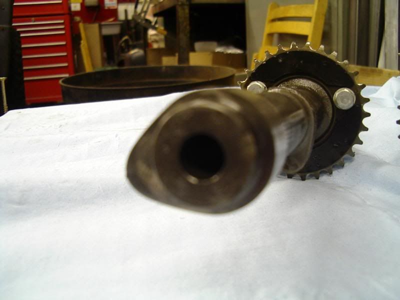

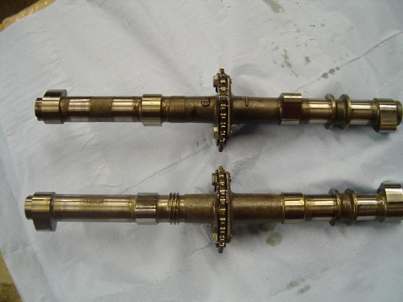

Camshafts themselves were in excellent condition with hardly any sign of ware.Notice the cams are hollow,think they were like that a fair bit into Z1A production

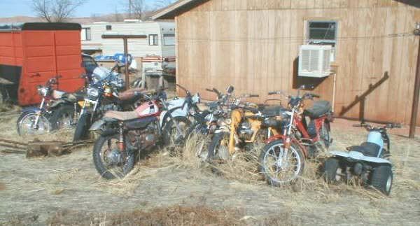

Hope Davy dosen't mind but this is how the bike spent a good few years of its life
can you spot it?

#20 PostAuthor: davejames » Sat Jul 12, 2008 11:27 pm
Great pics and info Iain, keep them coming.
Looks like the Zed far left, some of others would be good to salvage :D :D
