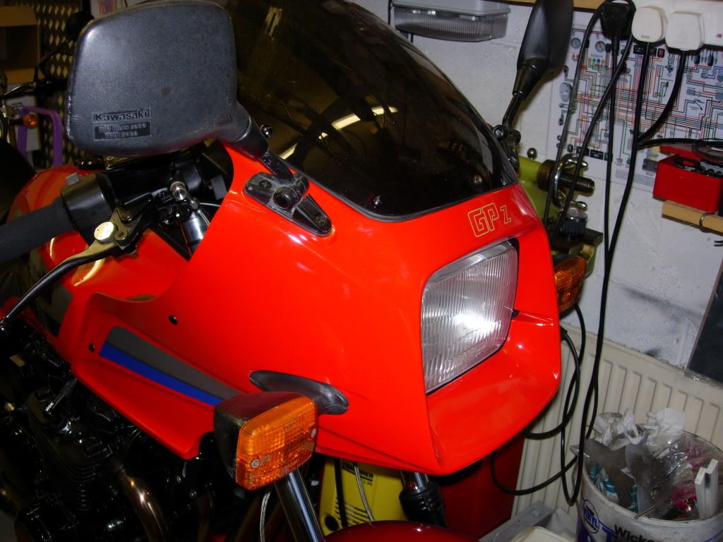

The fairing was next, I needed to do a small repair, which you can still see it's just below the graphic on the o/s, but it doesn't show in the pic, so that small part will probably get re-done.
The mirrors still need a bit of tlc & the o/s indicator will be replaced.
That's all I had managed to get done before Ralphy's last meet of the year, I had the original tank & sidepanels fitted & thought it would be great to blast it down to Shepton Mallet on the Sunday. So on the Saturday I wheeled it down the drive, got all me clobber on, started & warmed the bike, ready for it's maiden run. Pushed the gear lever down, let the clutch out, and........................................................................... Nothing.
It seemed the clutch wouldn't engage.
I was already too hot, so pushed it back on to the drive & wheeled out what is fast becoming my faithful old steed.... My money Muncher. We had an excellent blast & gave me the time to contemplate what was wrong with the Geepster.

Bloody hell that front end looks brand new :shock: Nice job.

Saw this bike in the flesh last friday
and the pics don't do it justice
GBs certainly done a nice job a credit to him

Yes, it looks superb.

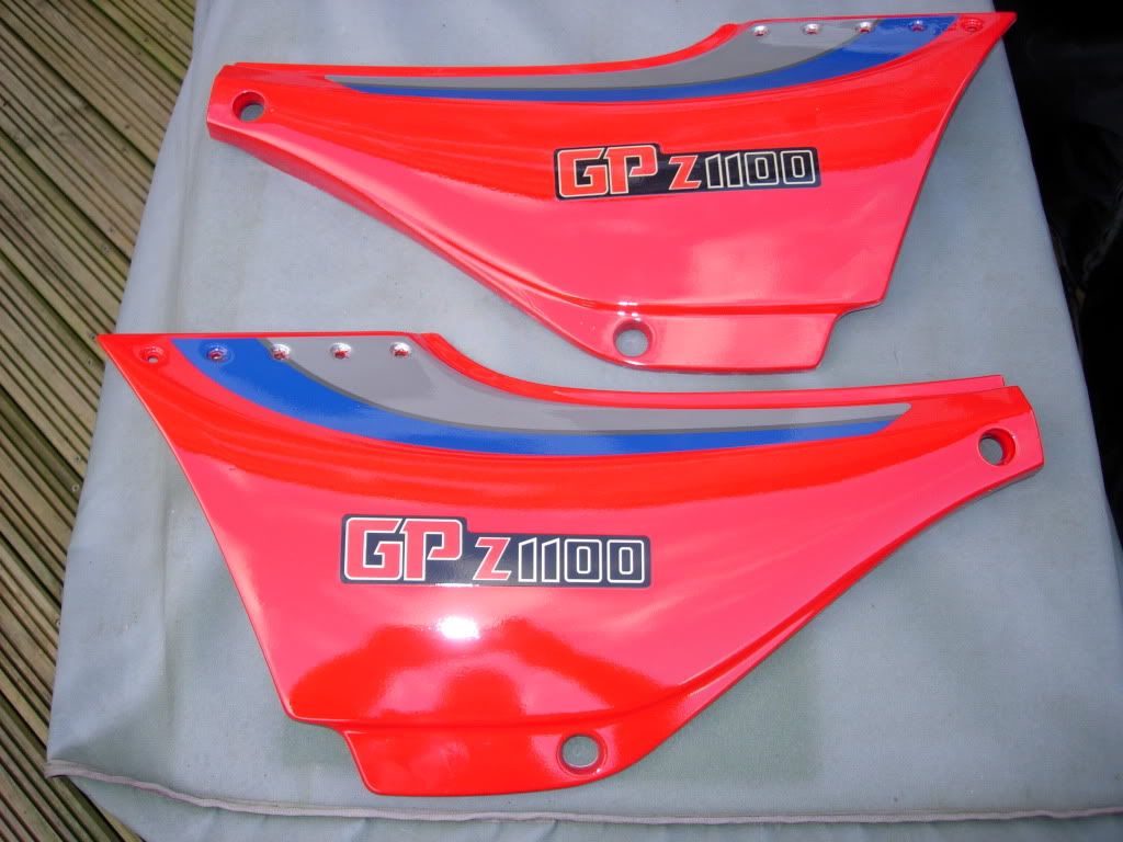

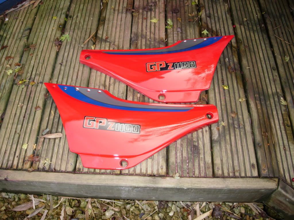

Back to my painting, these are my side panels;
I seem to be getting better with the clearcoat.
