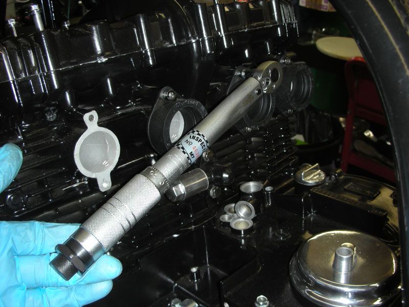

I fitted the carb rubber stub mounts; I know that cos here's a pic of me doing the job with my new 1/4" King Dick (yes that's a cue for Jimmock
 ) torque wrench, which I have found much lighter and more appropriate on the 6mm bolts in ally.

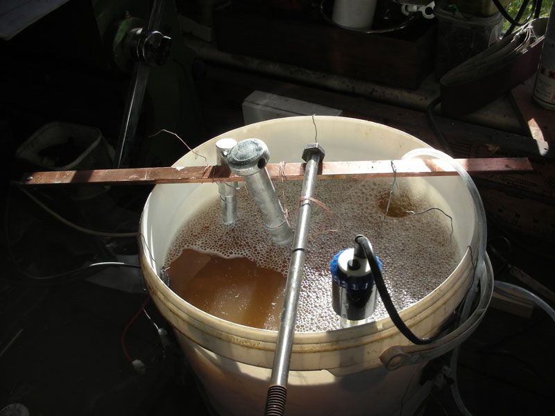

I did loads of zinc plating; as you can see I had to do the wheel spindles in two bites!
That wasn't very good as I had to take most of it off again as the plating made them too bloody big to fit the various holes grr

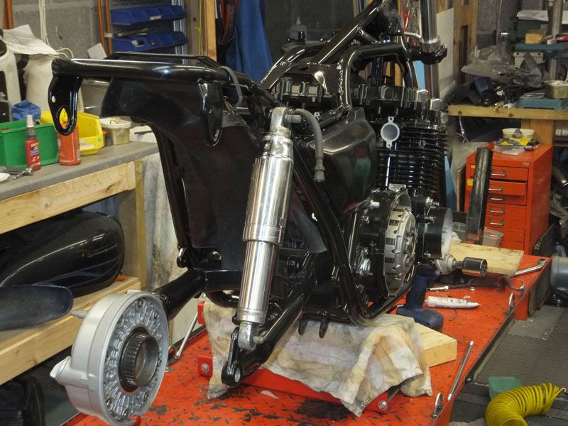

A couple of side on shots for Mr Puffin:

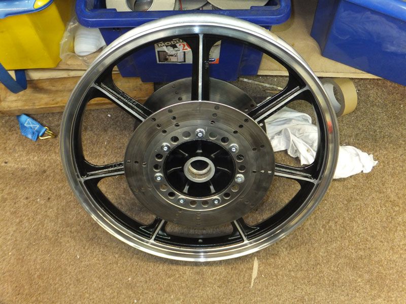

I put the discs on the front wheel, having blown the insides of the wheel over with a bit o paint from a rattle can - yes, I masked the inside bit when I painted 'em first time; forgot you could see through the inside of the discs on these wheels

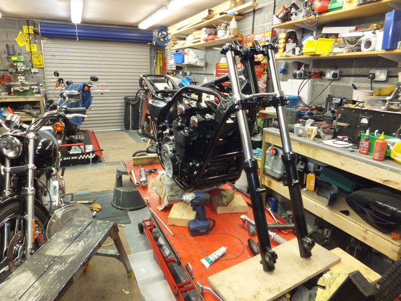

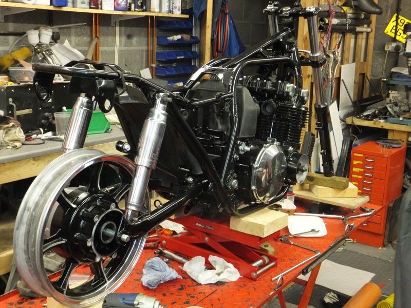

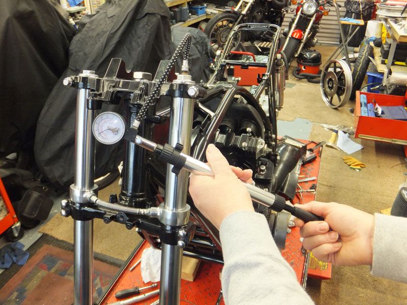

I fitted the front forks which was slightly tricky. With the help of CB I took lots of photos of pumping up the air forks, so we can show how the pump works on the BTB website

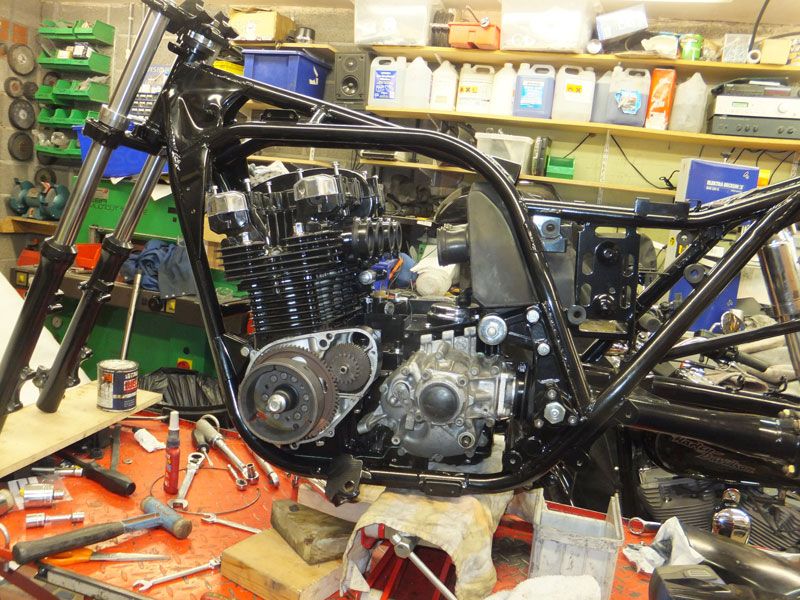

I painted up the casings with Wellseal to refit the alternator and fitted the gasket only to discover that the firkin rotor OR the windings are wrong
I'm not sure which is to blame grr, but they certainly aren't compatible.
Any ideas?

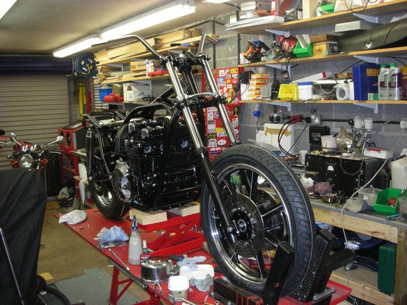

Here's how I have just left her

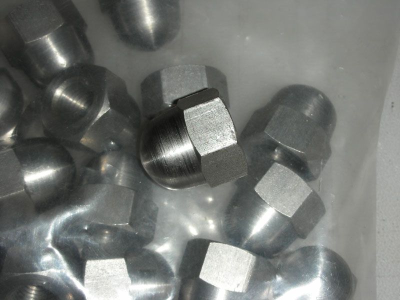

Took delivery of some M10 x 1.25 stainless domed nuts. They were a tad rough on the finish:

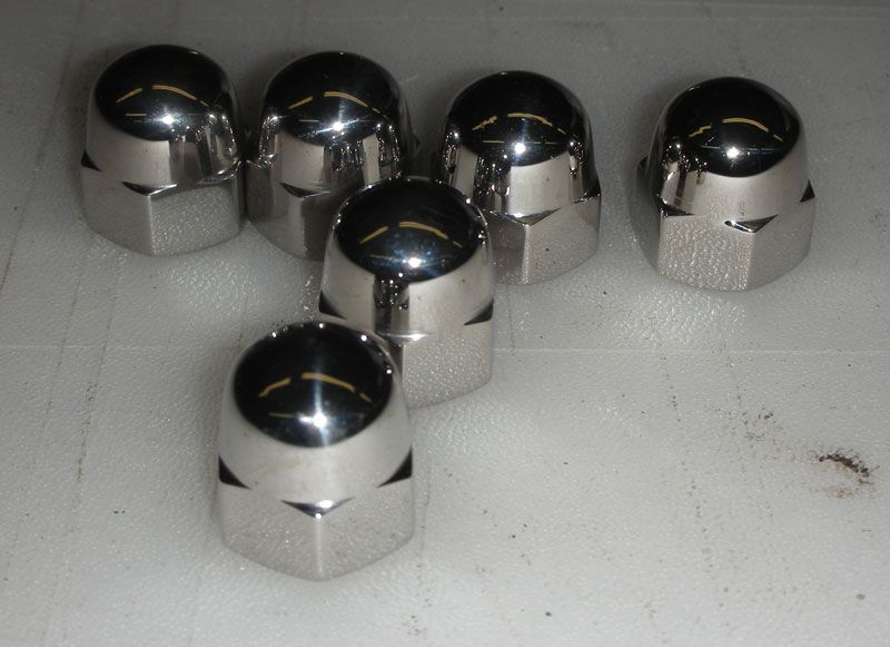

So I Mikey'd a few of 'em

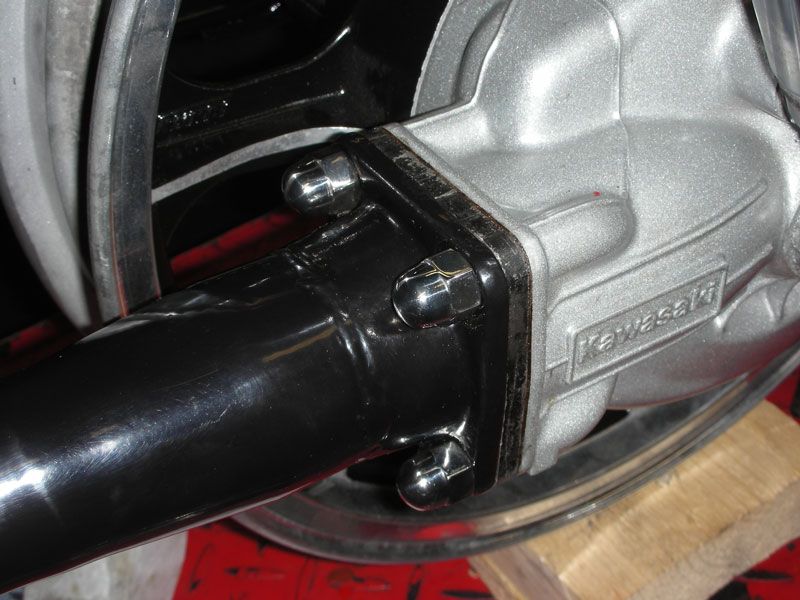

... and then stuffed four of 'em on the rear bevel box - those cad plated, plain nuts really didn't look right.

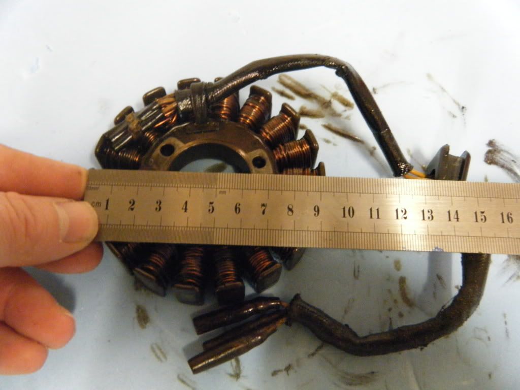

Padders, a veritable gentleman, nay Saint, was kind enough to send me down a winding for this ungrateful pile of ?@*%!!!!! Yes it matched the rotor, but then the winding wouldn't fit the bleeding casing grrr.
  In desperation I ordered a correct rotor from Electrex World for about nine million pounds I don't have and sure enough it'll fit the crank, though it does have an unnecessary key way on it, but I'm not convinced that it isn't a bit big for the winding; not sure what the clearance should be, but it does seem to have a pretty good air gap. I do wonder what the clearance should be. Praps they have a cunning plan to make folk buy both parts. As these motors have a tendency to shed their magnets, as the original had on this bike, I thought the after market one might be a better bet than a second hand one, which was less than a tenner cheaper on flea bay (DK) I've tried getting them to give me some trade before and they don't seem very forth coming

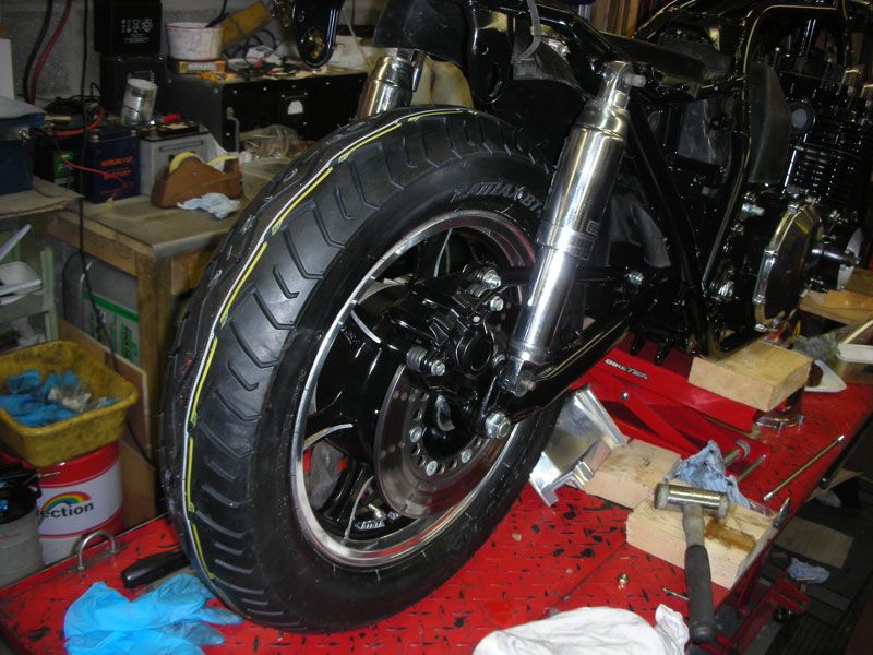

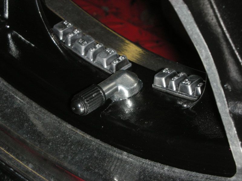

On a more positive note, I have now fitted both tyres and the wheels are in place. I have fitted Triumph angled tyre valves, cos I get so hacked off with trying to get air lines on the standard ones, which as you know is almost impossible. Sadly the hole in the wheels was bigger than it should have been so they're a bit of a sloppy fit. They're staying up, but I do think I ought to do something better.
