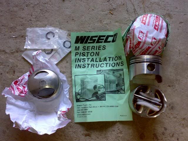

Doing a bit of engine work at present, just got hold of some better (1045) barrels & Wiseco pistons, and got some .395 cams that need collected from Steve (Romeo) Debben

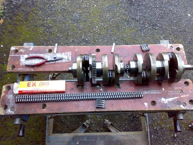

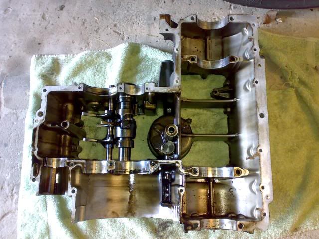

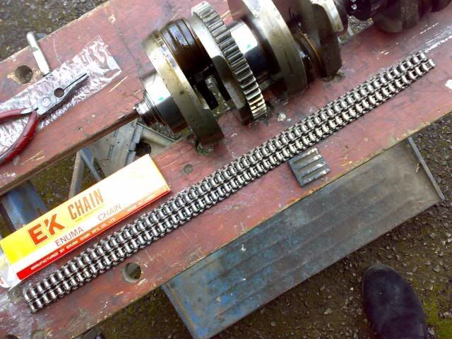

Well, actually been out in the garage this morning & finally split the engine
All went smoothly, all the bolts came out OK
Got the crank out at last so I can fit the new cam chain
The old camcahin is the lower one and when next to eachother the stretch is visible...
Got me new stuff ready for installation..... cheers Jeff
....along with the Wiseco & barrels... cheers Chrisu...

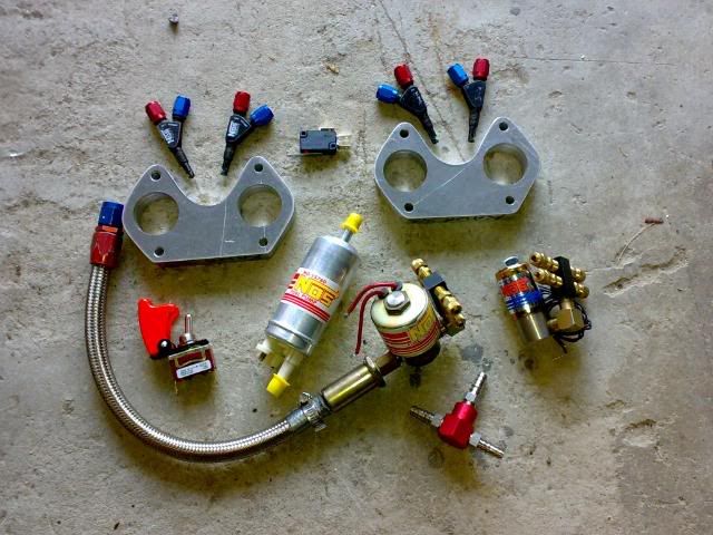

...and the other SPECIAL stuff..... cheers Steve Romeo D.....

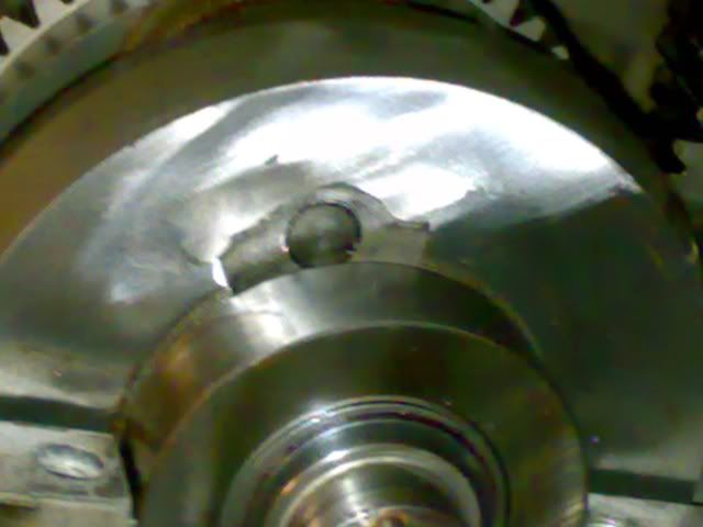

Looking at the bottom pic ... best you get that crank welded!

Finally got me crank welded...
The workshop Engineer at my work did it for me.... used a low alloy, hi-carbon rod or sumink
Cost me a 4-pack of Stella Artois

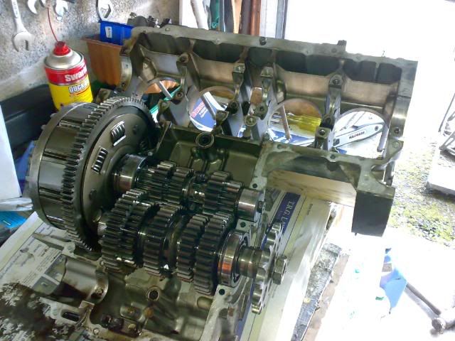

I've ground the weld back and cleaned it up. Fitted me new cam chain & with the help of me lad its back in the casing
Gonna get a windage tray from Steve 'Romeo' debben next week and hope to get cases back together by next weekend
