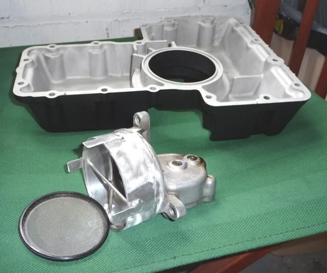

Additionally, I've at long last managed to get hold of a full deep sump (cheers KwackerZ1). There were 4 broken fins on it, but the Bentley Mulliner dep't have sorted that out now, and I've given it a fresh coat of Sperex Super Tough satin black.
The sump measures an extra 50mm in depth, so I've also had a spare oil pump (cheers Piggy) modified also at Bentley by adding a 35mm extension on.

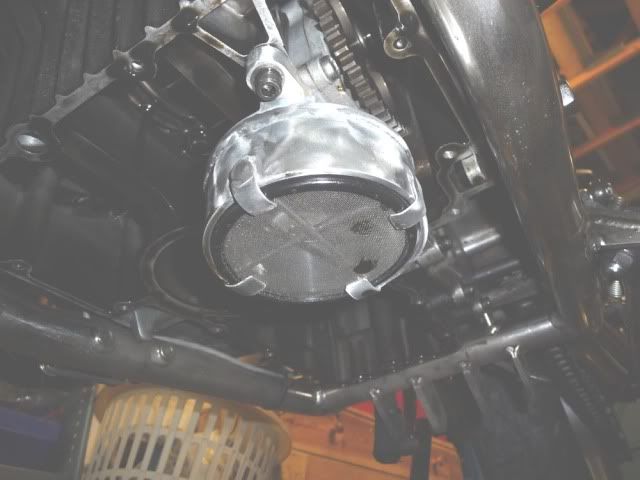

With a new seal installed and the pump torqued up, the strainer can be refitted and the tabs folded over.

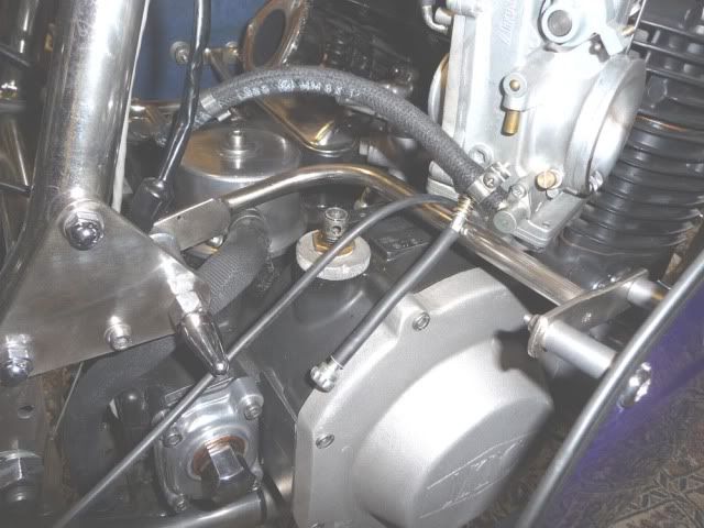

Next job is to also change the routing of the turbo oil drain. I will be tapping into the MTC clutch cover about halfway down, this will give a 3" decline to stop oil backing up to the turbo. At present the drain is actually on a slight incline which just may add to the occasional smoking problem.

Deep sump:- Well as far as I can see, no way has this sump ever been fitted before.! With the extended oil pump fitted there's more chance of knitting fog than getting the sump to clear the oil pump. In fact, even after fitting the old standard pump back on, the sump still won't clear :??
Fortunately, the sump is as thick as a dockers butty and with a bit of 'thinning' here and there it should fit OK.
