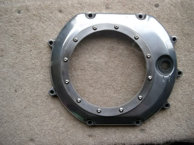

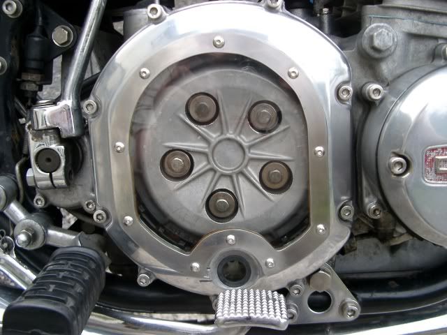

#11 PostAuthor: Jumbo » Wed Apr 29, 2009 1:54 pm
I managed to finish the window which became two in the end. Thanks to "ludders" for the Lexan and TLC for one of the covers.

#12 PostAuthor: Pigford » Wed Apr 29, 2009 3:52 pm
Jumbo....... that look very smart matey :twisted:

#13 PostAuthor: tlc » Wed Apr 29, 2009 4:58 pm
Forgot I`d sent that to you.
Looks darn good......................................how did you cut it ?
