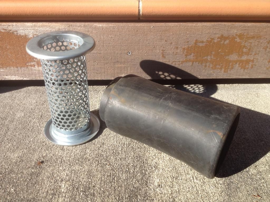

Who knows what (sound) insulation material goes around the spool in the air-box silencer pictured below? Seem to think it was foam rubber, could be paper?
I seem to remember seeing the spool with paper on it assembled, called a filter, on eBay... Never followed it up!
Image[/URL]

seem to remember a post about this a while back, someone used a flameprook material/foam

I thought it was foam too. Are you knocking one up Garn ?

G, I'm just supplying the dimensions and someone else decided to make one... If it works, i get his know-how and proceed with one myself.
I could imagine it being a fire hazard if soaked in fuel!

I've always used ironing board foam...around 6mm thick usually Green or Cream colour, and probably relatively heat proof....I never had my A4 blow up at any rate. :lol:

high density closed cell foam is what is used

Garn l use air filter foam the universal stuff you buy in sheets that you soak in oil.
l have a NOS Silencer if you need measurements, yours looks a bit saggy.
l.ve always wondered about these A4 filters, pic looks like its for silencer but discription indicates convential air filter replacement, which is not correct for A4.

i fell for the "looks like the silencer filter" after a few beers. doesnt fit the silencer and also dont fit the standard airbox. they are round so will not fit,

Does any one have the dimensions of that "Hi-Flow" [HFA2901] air filter shown in the above eBay sale.
The dimensions of the steel spool in my photo (post #1) are 94mm outside rims dia and length is 158mm and bore is 60mm dia.
That EBay, Z900 -A4 item, is it what it states? both RGH & Wayne say..No!...
Z1Bman will know!
RegardZ.
PS. For RGH, the outside rubber is a bit sloppy, it stiffens up when the spool is inside... Just like mine!

the filter on e bay is not from any of the 900 series
z1/a/b filter
z900 a4 model
