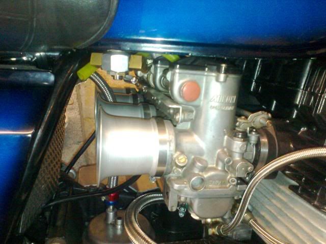

#3 PostAuthor: Pigford » Tue Mar 25, 2014 12:55 pm
Here you go..... on me MkII with 33's.....
Got them on me VM29's now, ready for the harris :wink:

GUS those conical ones are a bit short but the right idea what I want is those like PIGFORDS but with gauze on the back. I actually have the trumpets just need protection
Mark do yours have gauze or are they straight through?

#7 PostAuthor: Pigford » Tue Mar 25, 2014 6:20 pm
KWACKERZ1 wrote:Mark do yours have gauze or are they straight through?
No gauze I'm affraid :|
