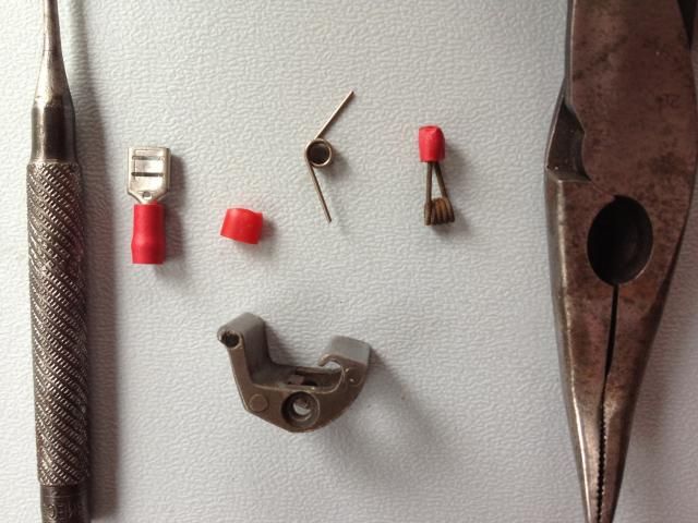

Steveh, Here's one of my best tip for this job....
The insulation on the small spade terminal is cut in halves to form a spring retainer for purposes of assembly. It may be flicked away when toggle is assembled!

#5 PostAuthor: steveh » Sun Oct 06, 2013 11:08 am
Job done. Thanks guys, great advice as usual.

#7 PostAuthor: Z1parR » Thu Aug 28, 2014 8:42 am
Used your method yesterday Garn .
Absolute piece of piss one man operation :up :up
