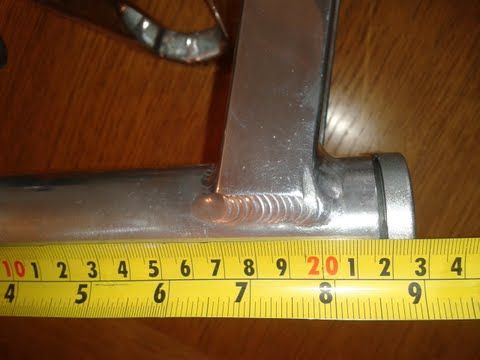

I have a Metmachex swing arm lounging around in my garage doing not a lot. I bought it for my Z1R but have changed plans and I'm fitting a Dresda unit instead.
While the original arm was off my Z1R yesterday, I offered the Metmachex arm up and found the pivot was about 5mm too narrow to fit the Z1R. I've measured it at 226mm (roughly). There's no marking on the Metmachex arm to indicate what it might fit.
When I bought it, I was told it was for a Z650 / Z900 / Z1000, so assumed (now there's a word at the centre of most *uck-ups) it would fit.
From the photos, its clearly for a twin shock bike, has mounts for the brake torque arm on both the upper and lower side of the RHS, which may indicate its for a bike that has either a drum or disc rear brake. Any ideas?
[img][img]http://i1273.photobucket.com/albums/y413/FredtheZed/SwingArm1_zps21e9208c.jpg[/img]
[/img]Image
[img][img]http://i1273.photobucket.com/albums/y413/FredtheZed/SwingArm2_zpsd55193ff.jpg[/img]
Any ideas??
Fred[/img]

they usually stamp the model fitment on the swing arm pivot tube

On the Z650 Metmachex, both spindles measure 315mm long from the base of the head to the end of the threads.
The pivot spindle is 16mm and the axle spindle is 17mm, which is 3mm smaller than on the Z900/1000 axle spindle.
I have the spindles in my garage from my Z650 MM arm but not the swingarm itself so I cannot measure the dimensions of that. As said, the model fitment on Metmachex swingers is stamped on the front edge of the swingarm pivot.
Mine says Z650/750.
Is that one gonna be for sale ?

Taffus wrote:they usually stamp the model fitment on the swing arm pivot tube
Mine was clearly stamped on a flat area of the pivot tube Z1000, it also had end caps which I had to modify to fit on my Z900.

#6 PostAuthor: Fred the Zed » Sun Sep 15, 2013 5:07 pm
Charlie wrote:On the Z650 Metmachex, both spindles measure 315mm long from the base of the head to the end of the threads.
Mine says Z650/750.
Hi
Yep its for sale, but it would be nice to be 100% sure what it was made for. On the plus side, a couple of spacers and it could clearly fit the Z1000 / Z1R. PM me if you are interested in purchasing it. It's going on Ebay on Thursday evening if it doesn't sell beforehand.

#11 PostAuthor: Fred the Zed » Tue Sep 17, 2013 5:14 pm
The arms measurements are:
Pivot width - 226mm
Space between insides of the rear chain adjusters - 226mm
Space between shock mountings - 260mm
Distance between centre of Pivot and centre of chain adjusters - 505mm
Fred

#14 PostAuthor: Fred the Zed » Wed Sep 18, 2013 6:24 pm
Oh, and the rear wheel axle / spindle is 20mm diameter.
