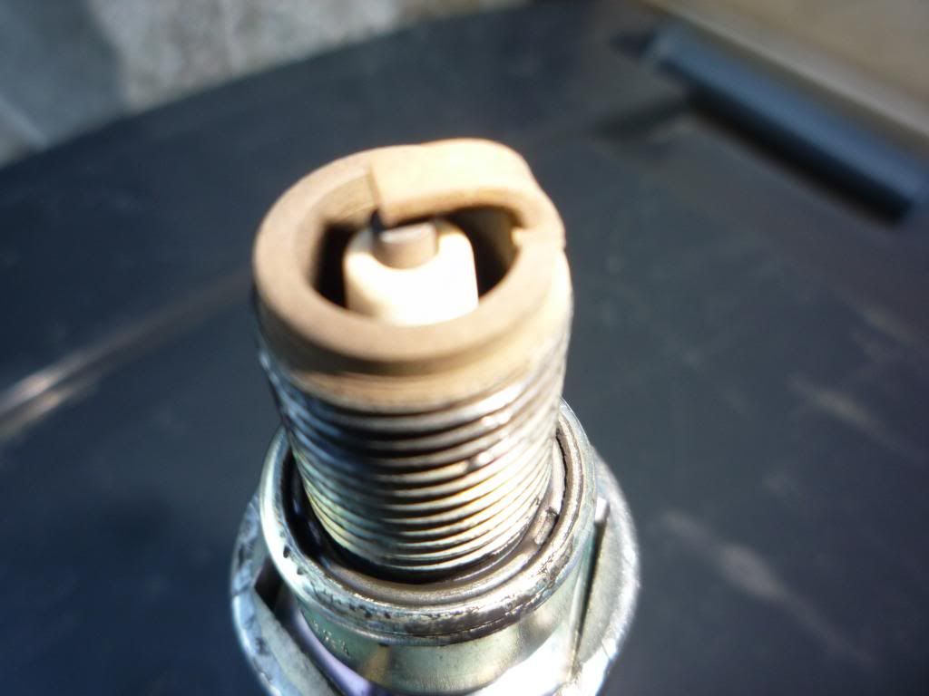

I whipped out # 2 plug just to check - pic below - does this show a bit lean ?

#7 PostAuthor: paulmceleney » Sun May 26, 2013 8:04 pm
no that what everyone want there plugs to look like that is the best

#8 PostAuthor: KeithZ1R » Sun May 26, 2013 10:16 pm
Feck me the mythical "straw coloured plug" save it for posterity :lol:

Charlie wrote:How much smoke and what colour is it ?
I would go back to this before deciding to play with carbs. Blue = Oil, Grey/White =Rich mixture which, looking at your plugs, I would say is not your problem.
