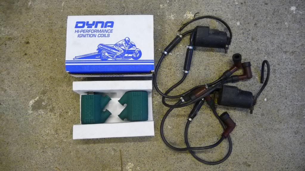

Dave, I had used straight through connectors for the same reason on my Z900 A4 for a couple of years, upgraded to Dyna 3 Ohm coils with Dyna S ignition now.....the expensive route !
Got the connectors from Auto Electrical shop but you should be able to get online somewhere now I guess.
http://i1278.photobucket.com/albums/y51 ... 4a8973.jpg
