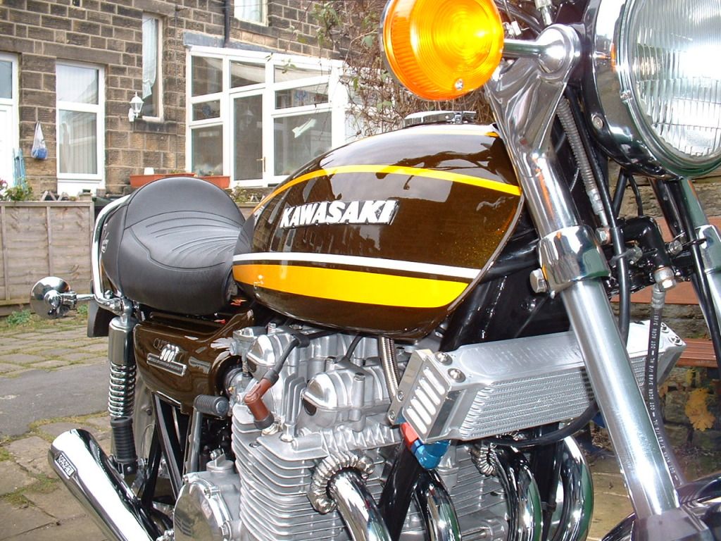

Ive fit a few coolers over the years, take into mind how much room you have including the mountings and what type and dimensions of fittings. Also check how much stearing lock you have, this may determine how wide the cooler can be

If you are using the cable drive for the tacho this limits the room you have. If you are using electronic tacho and the head has had the cable drive blanked off more room. I used cable drive on mine ( see photo in last post) This limited me a lot on size of cooler. Hope this helps you.
