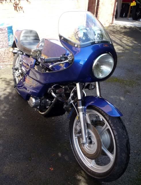

I went straight to Goodrich direct, they made mine up on the Saxon.
