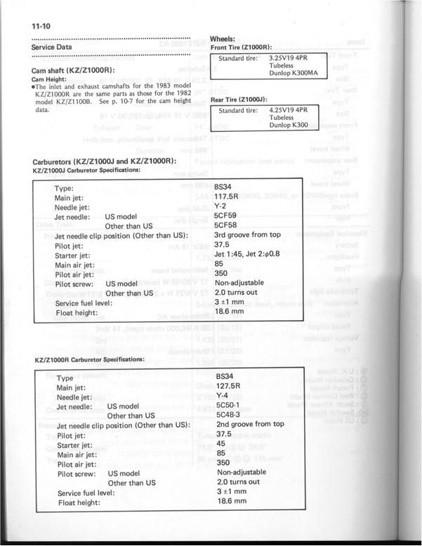

#14 PostAuthor: weaver » Mon Dec 10, 2012 4:18 pm
had a look on the cmsnl website at the z1000r and z1100r diagrams,the carbs appear to be exactly the same apart from an extra part on the z1000r diaphragm assembly
the top one is the 1100...
