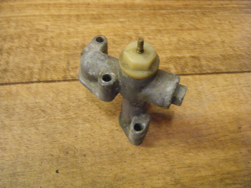

Just bought a z1b. the oil light doesnt come on. (bulb is ok) engine runs fine though. I get 12 volts to the wire that goes to the switch. does the switch earth the wire when the engine is not running so making the bulb come on.
I have removed the switch. it does'nt seem to make any difference if i do a continuity test on the switch, ie with the plunger pushed in.

Thanks padders, was thinking the plunger on mine might not be going down far enough and earthing, Ill have a look in next couple of days, if i cant get it sorted ill have yours please, I'll let you know how i get on.

jimmock wrote:Works just like a courtesey light switch on a car door pillar.
Does anyone know at what pressure the light comes on at??
I'd imagine about 6psi??
Light comes on when pressure drops too low - some less than 2psi..... But it also depends on oil type/viscosity too
Pigford wrote:jimmock wrote:Works just like a courtesey light switch on a car door pillar.
2psi??
I think the engine would be wrecked BEFORE the light comes on!!
