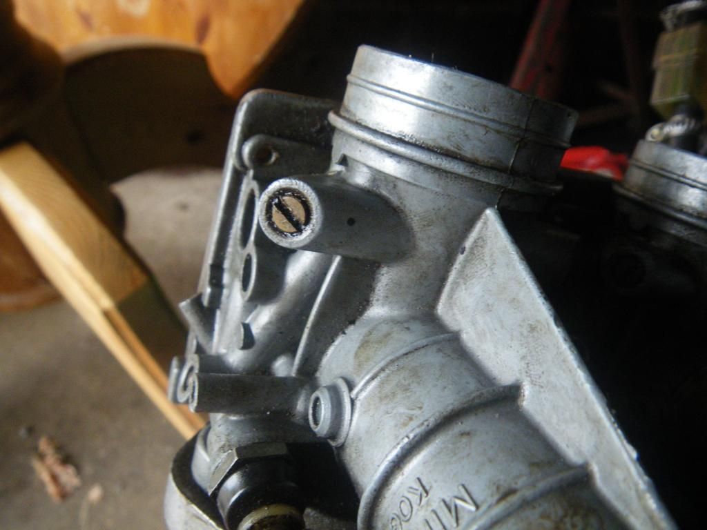

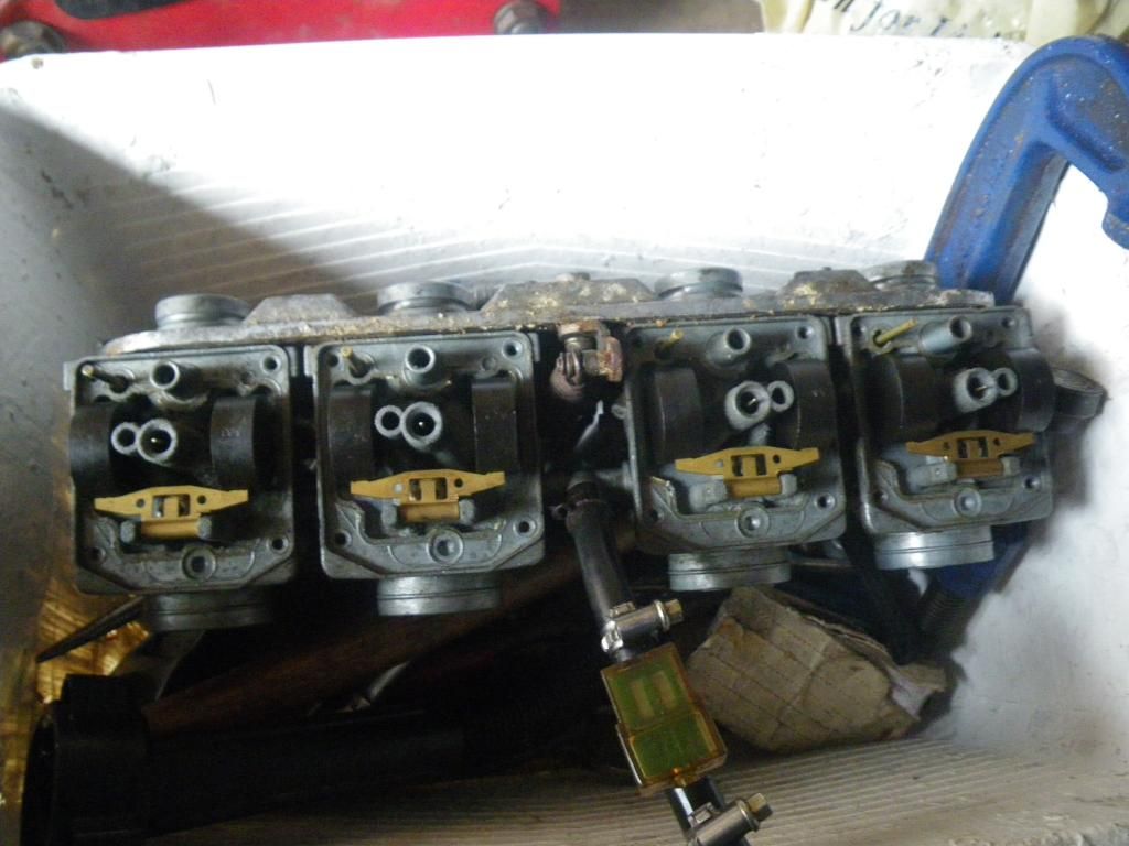

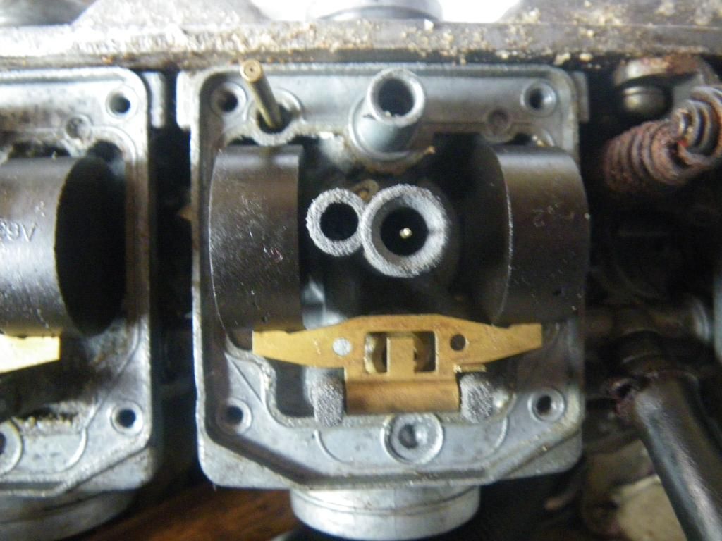

Garn heres some pics of my carbs, see what you make of them,

#5 PostAuthor: chrisu » Mon Oct 15, 2012 1:54 pm
no pilot jets, mains or emulsion tubes in there !
try nrp carbs.................

#7 PostAuthor: chrisu » Mon Oct 15, 2012 1:57 pm
they're not A4 carbs though.................
only a single fuel feed and A4s have 2 feeds - to left/right bank of carbs.

#10 PostAuthor: chrisu » Mon Oct 15, 2012 2:08 pm
z1000 then............... probably A2 given the vaccum takeoff on the fuel tap.
i'm sure someone more knowledgeable than me will be along to recommend main jet size uplift.........

#11 PostAuthor: kev edwards » Mon Oct 15, 2012 2:14 pm
Looking at the ribs on the slide housing tells me the are 650 carbs, i've never seen ribbed on 900s or thous.

#14 PostAuthor: Crofty » Mon Oct 15, 2012 2:52 pm
ash, they are 24mm 650 carbs, you were asking about 26mm carbs as fitted to Z900A4 etc
I think I might have some emulsion tubes and mains etc, pm me if you need me to check.
Thought you were doing webers?? or maybe your thinking of going to 26mm in future. I'm like jimmock, confused
btw they look to be reasonably clean inside and also they did a 22mm version with ribs on as well, but not on many models of 650
