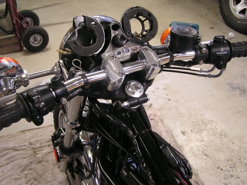

Bob fell......anyone who knows how to use a lathe or mill could knock up a set of risers for you in a few hours.....i just gave the original clamps to a machinist and stated that i "wanted a pair of these made but out of alloy/stainless steel instead and lengthened by about 3 inches"

Thanks again, cool pix too, I can actually get blocks of alloy (off cuts) from work ;) I guess a way to go would be to measure the distance of the position of the brake and clutch lever from the floor and then figure out how big the riser would have to be. Can I use any bars as long as they are the correct diameter? The flat bars really enhance the look of the street fighter type style
