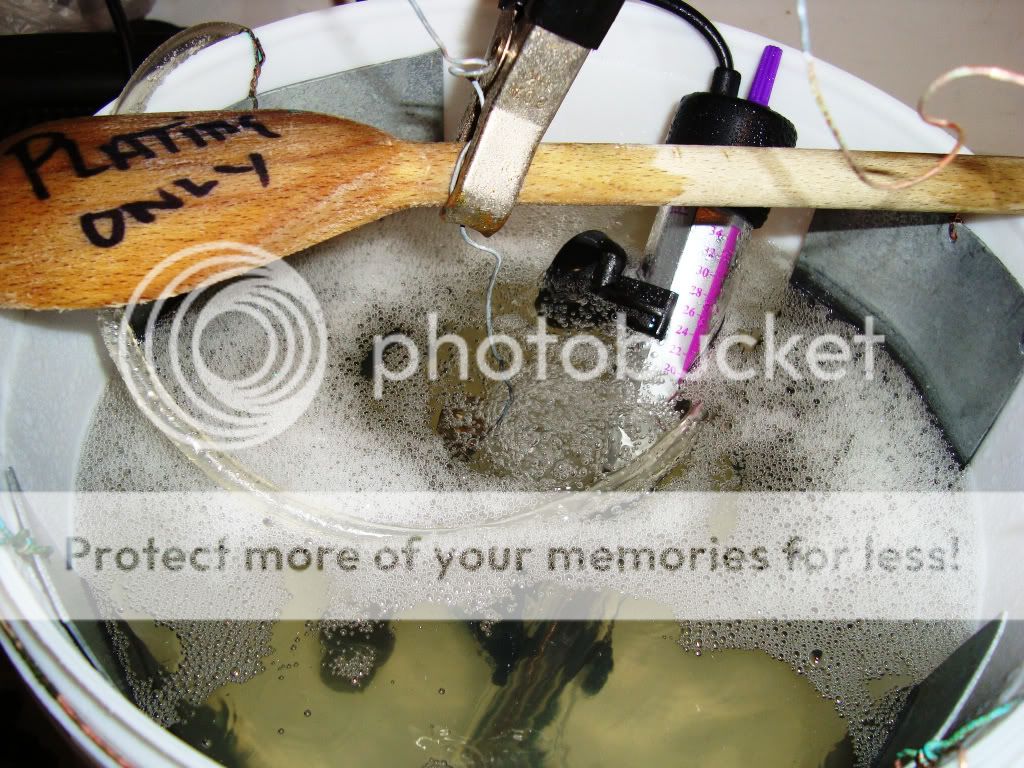

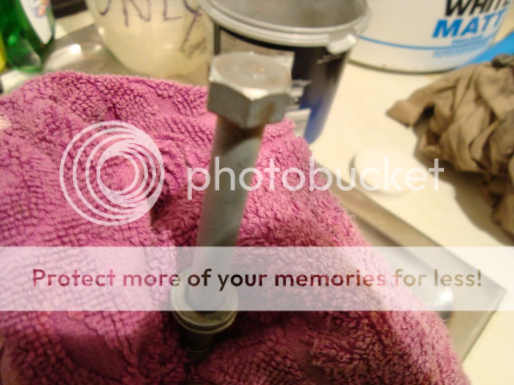

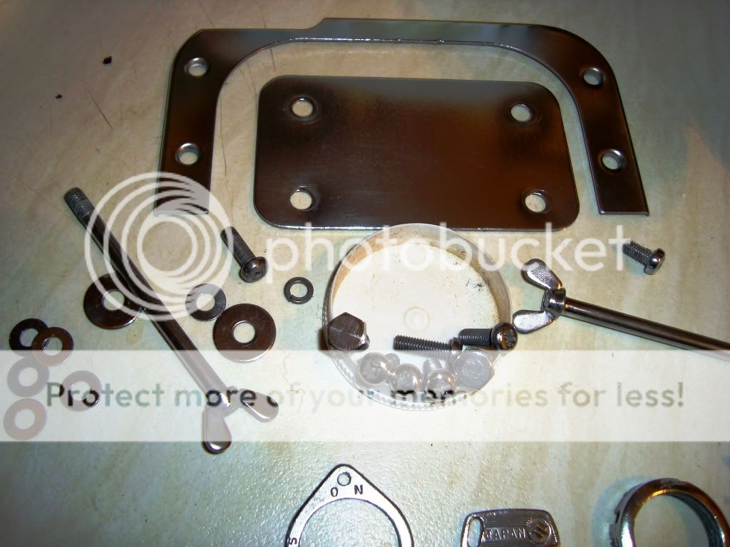

I use a small zinking kit, and i put them (rusty bolts/pieces) in patieo cleaner, then rinse, copper wire, into the zinking kit, for 15/20 mins, comes out, gray, rince off, wipe off, then polish on a small 8" grinder wheel, with a polishing mops. Then into the orange passivate! job done.
Polishes up like chrome. I use this for only small parts. but a saving is a saving, and not wait for a few weeks, to get it back. I can take it off, the bike, in the morning, and put it back on the bike before lunch!!!

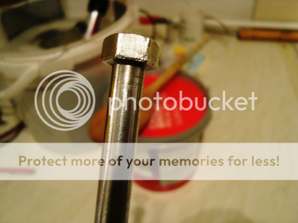

Once it's been zinked
then polished

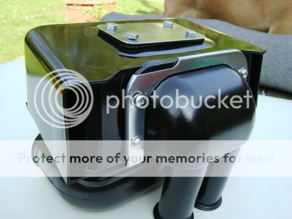

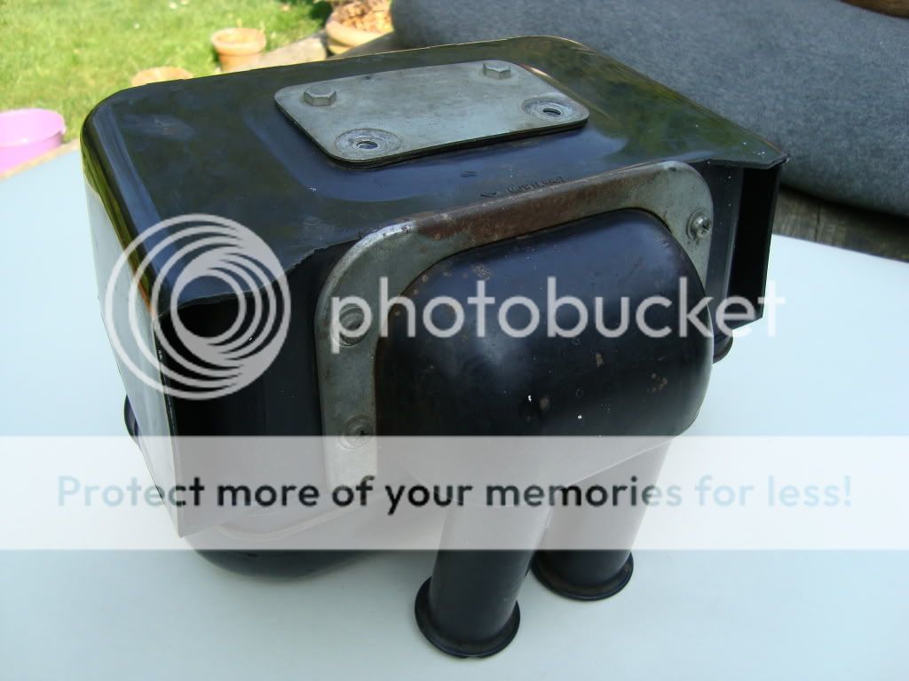

And some air box parts, not kawersaki.
Air box before restoration.
And the completed Restored air box. Good for another 40 years. Job Done!
