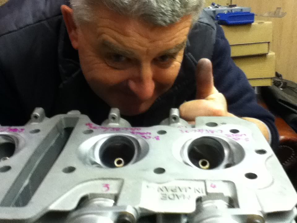

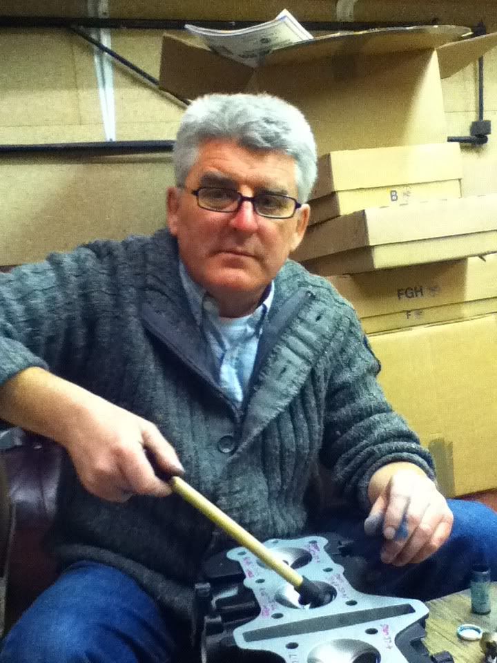

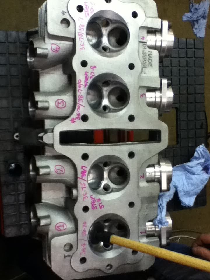

KeefLeef asked my to put these photos up of the club's "head Guy" Buzzard

i agree - buzzard does do good work.
