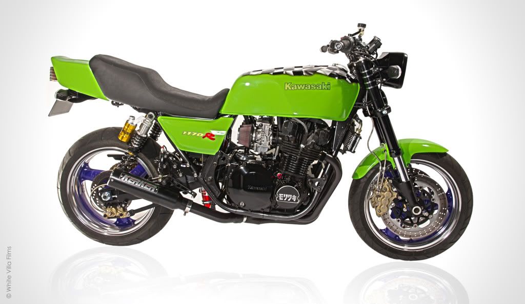

I have an XJR 400 Mudguard on this, I'll try & measure the width tomorrow.

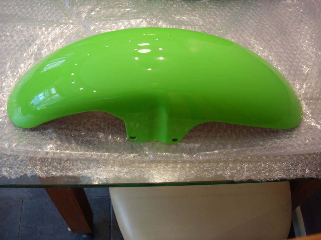

Could try one of these. (black, they also do a red one).
http://www.patternbikeparts.com/product ... uctID=4259
