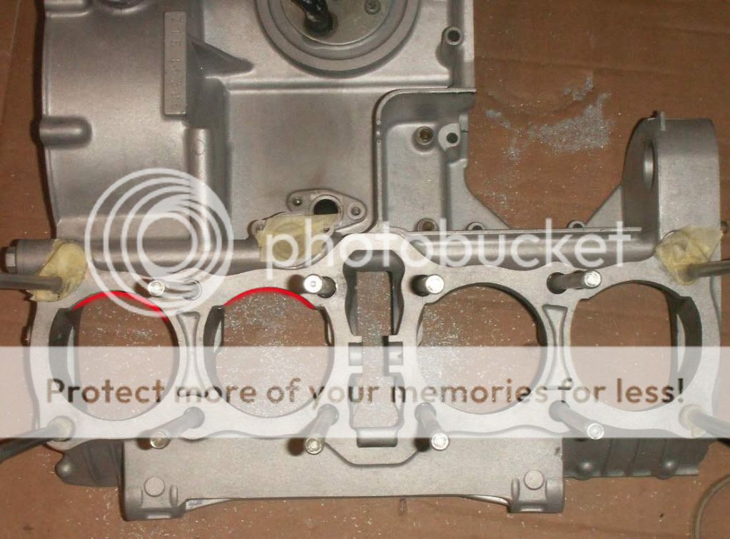

#9 PostAuthor: hanskloss » Sun Nov 27, 2011 10:16 pm
as I've just begun with my A4/Z1/1075 construction I can confirm the Z1 cases have to be skimmed/filed, bores in the casing are cone shaped cast so when I measured the tops with vernier caliper it looked OK, but when tried the barrels on they wouldn't go fully in, it's only about 1mm to take off so easy file job but definately not on a complete engine, on the photo two left cylinders are done
