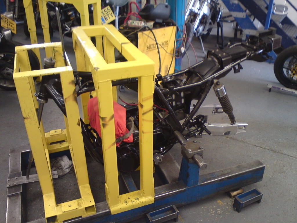

Im going to strip and paint my frame over the winter and i thought id have it put on a jig to check its straight ,has any one got any idea who has got a jig and the tools to do a z1 frame

Just look on the web for your nearst motoliner it's not cheap if they are bent though.

I'm sure you will need to leave in the engine,swing arm and back wheel.

GUYZED wrote:I'm sure you will need to leave in the engine,swing arm and back wheel.
I have just been through this with Seastar Kawasaki - they have a jig and did Rod Gibson's Z.
You have to remove everything except engine and swing arm which has to be taped to the rear down tubes(for set up).
They prefer the rear wheel out.
Cost is £75 for set up on the jig plus £50 per hour for each hour worked. Mine is going in on 3 December, subject to getting the bracing kit in time from Pitstop. RobW is going to help me get it there - about 35 miles from where we live.

Took my frame to this lot;
http://www.motoliner.com/
It's a bit of a 'day out', but they will do it for you the same day (by appointment). Cost was £70 to check it over, any additional work was charged by the hour.
