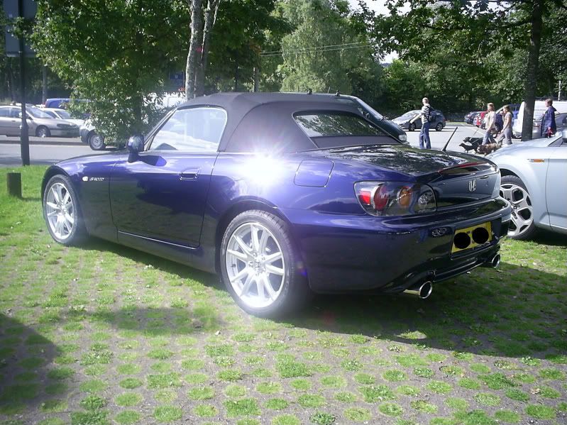

Paintwork depends on how much time you want to invest, but a bucket of soapy water and a £5 bottle of turtlwax wont really cut it if you wan't a proper finish........being VERY sad I invest ALOT of time on my paintwork, but 'I' think it's worth it
As as an Eg Some of my old cars....
I just love reflection shots.....
Detailing by Mr Conehead!..
