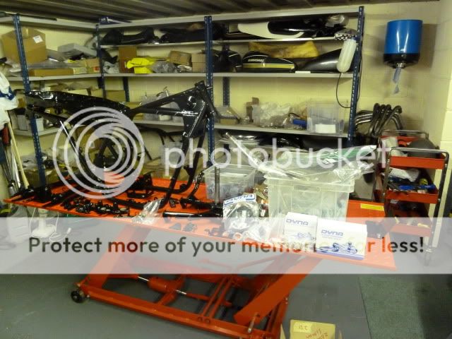

Just a quickie. I've now got most of the bits back for my 650 rebuild which have been nicely powder coated, chromed, zinc'd. All the threads on the various parts, nuts, bolts etc have either been blasted or plated and are all virginal. I remember buying some bolts from Tigafi who recommended applying a little grease to the bare metal before assembly. What do you guys reckon? Is it worth lightly greasing the threads, in particular parts of the frame which have been blasted prior to coating as the surface is slightly rough? Any other ideas?
Here's a piccy anyway :D
