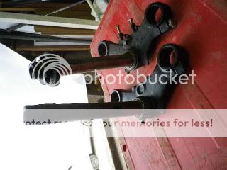

[img][img]http://i315.photobucket.com/albums/ll451/KeefKawa/z1yolks005.jpg[/img][/img][img][img]http://i315.photobucket.com/albums/ll451/KeefKawa/z1yolks004.jpg[/img][/img][img][img]http://i315.photobucket.com/albums/ll451/KeefKawa/z1yolks003.jpg[/img][/img][img][img]http://i315.photobucket.com/albums/ll451/KeefKawa/z1yolks002.jpg[/img][/img]Image
Yolks on blue tarp` and on car wheel,[same pair different backround].
Front one has blanked off steering lock hole but slot in stem.
Back one has steering lock fitted.Neither have hole for steering damper.
Yolk on forks has blanked off steering lock but no slot in stem?Does have
steering damper hole
Yolk in red oxide has a "mirror image " 3 ..date code?

The one in red oxide looks to be the type you need, the steering damper on that one fixes up into the centre stem had one on mine, the other two yokes look to be 650 and later model where the locks were on the side or in the ignition barrel, if you use 650 yokes the forks will hit the tank.
