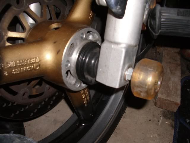

Me black Z1000 has a stripped fork bottom, where the spindle/axel screws in :?? The l/hand side (the side without a disc :shock: )
They are mid 90's GSXR USD forks :!:
Heres the offending side - note the temporary "bodge-job" to ensure the front wheel stays where it should :lol:
I need it repaired...... Its the l/hand side thats Cream Crackered. The spindle screws into the l/hand fork and locates positively. The r/hand fork hold the spindle with pinch bolts, so the forks can "naturally" find there spacing, so as not to pull them out of parallel :|
Anyone got the skill to do a repair on them for me - for beer tokens :?:
Though best fix maybe to turn the spindle thread down a size or two - then re-tap fork leg a size up, and make a sleeve to fit inside, to take spindle :??
Any other fix ideas welcome (except from Paully :roll: ) Cheers
