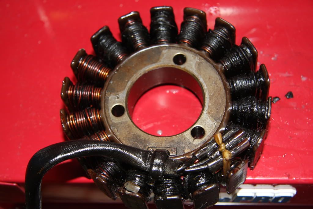

Here you go GB, this is my alternator from my GPz1100: this bike has twin Cibie 55/65W headlights and Dyna coils.
The alternator output is 280W at 8500 rpm and LESS under that rpm.
I now run with only 1 headlight on dipped but both on full beam.
Mathematically the system should be able to handle the lights and the coils but while I chase through the system looking for more faults (ie previous owner butchery) I will run it like this
