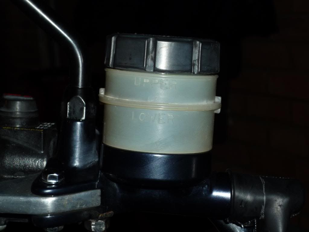

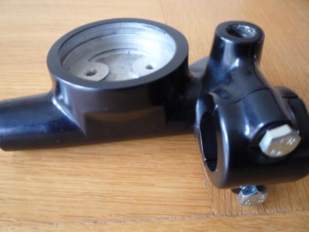

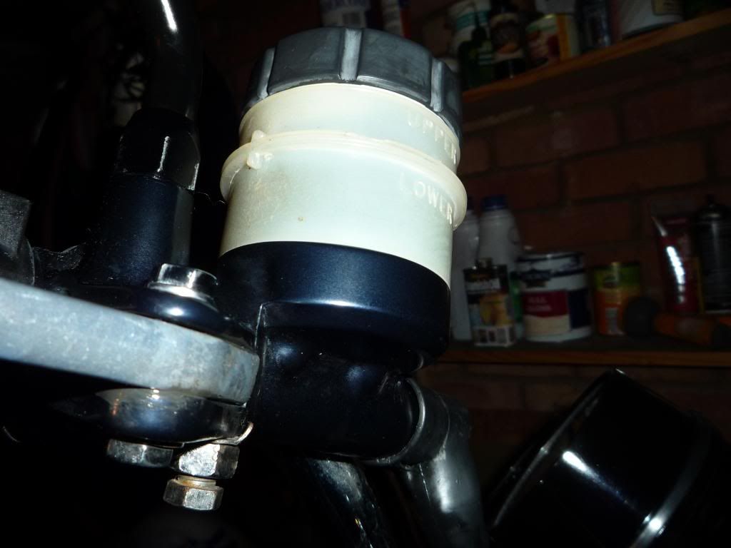

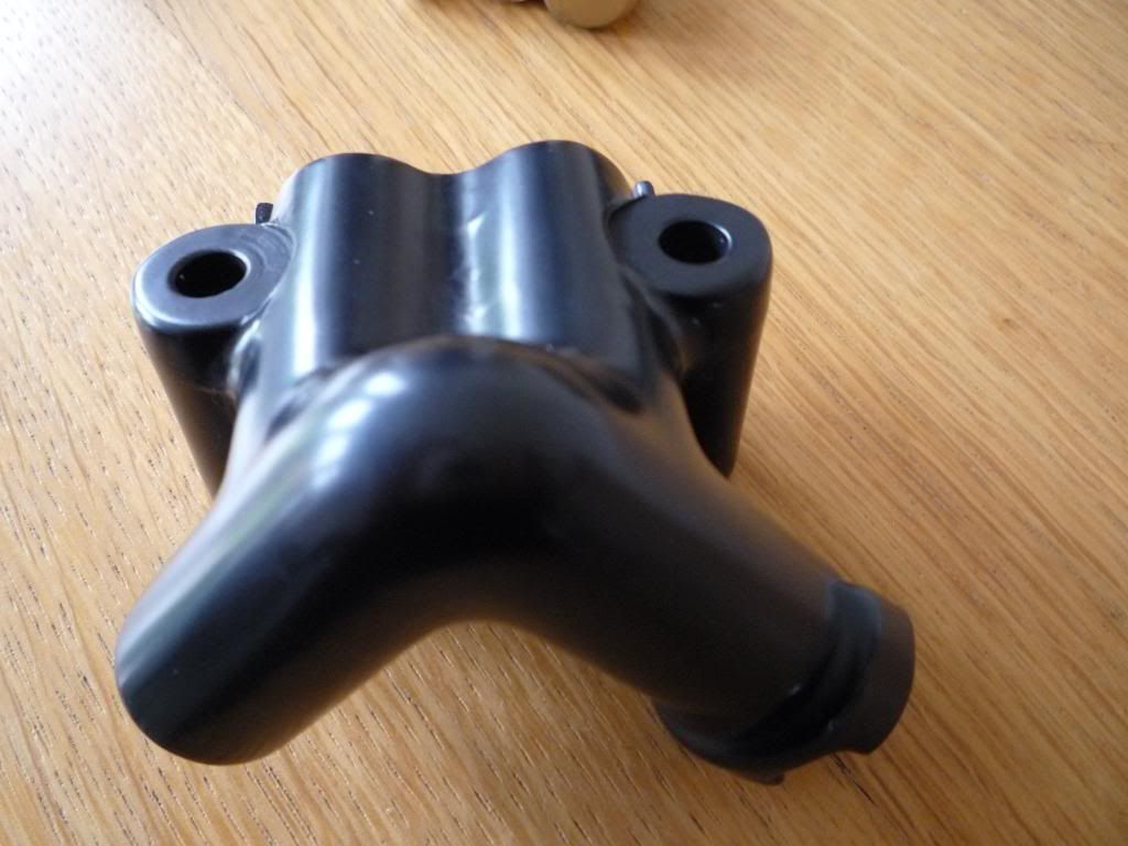

#22 PostAuthor: tlc » Mon Oct 05, 2009 5:52 pm
Just got the bits back from Mark and I have to say the results are excellent.
One word of caution though is that they are so smooth they will slip out of your hands as easy as anything.
Total cost including postage to Mark has been £130. I got him to fit a new rebuild kit as I didn`t see the point in doing it myself when he already had the bits and is more experienced than me.
I got Mikey to zinc the other bits and was well pleased with his work.
Bearing in mind there were parts to be BZP, gold passivate and chrome plate.
It took no time at all to whack the parts together and I was fortunate that the O ring was in excellent condition. Also Mark explained that the anodising process can destroy the bore if there is any corrosion at all in there. Luckily mine was good, in fact one of the best he had seen :D
