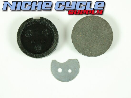

hi all, hope you can help,took of front brake caliper to change pads, the shims or spacers fell out 2 of them one plain and one with a raised bit in the middle,from the piston side.how do they go back in any pic's or diagrams will great.tryed to look on web but no luck.

I think you may have dropped two pieces
1. the small anti squeal shim! zThis is usually located by small pins at the back of one of the pads, hence it goes against the piston.
2. the surround that holds the rubber dust cover, that is usually a light press fit in the caliper body.

hi,garn1,thanks for reply, but mine look different of the a4 1976.

#4 PostAuthor: Keefleaf » Sat May 11, 2013 1:40 am
The round one with raised centre should have cross head screw going into back of the pad.

#5 PostAuthor: royboy » Sat May 11, 2013 3:44 am
keefleaf , thanks all right now.thanks
