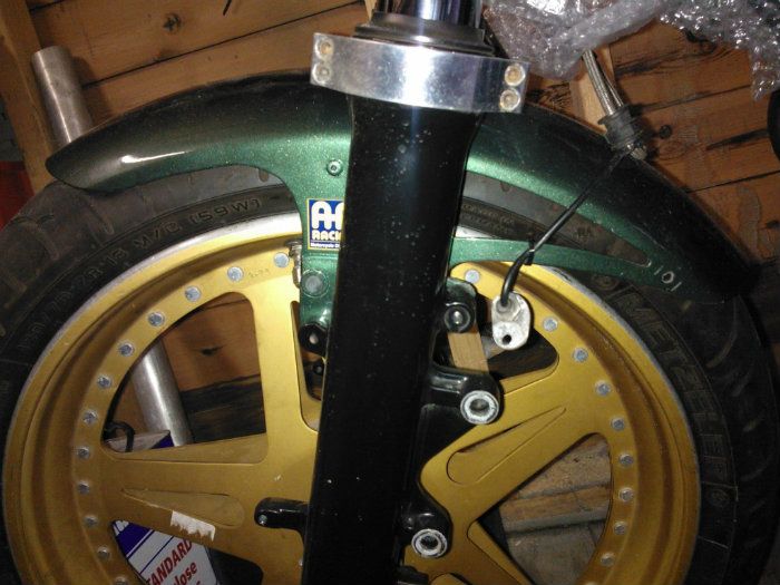

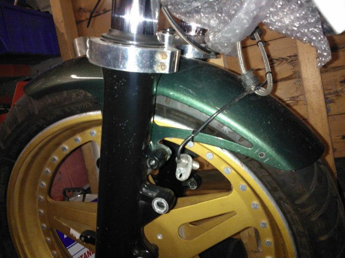

#12 PostAuthor: j.b » Sun Sep 23, 2012 6:08 pm
used a cut down early gpz750 front muddy on mine jim, if you decied to steer away from a flat topped muddy.
ignore the wheel being out of place because it has no hubs still....i repositioned the mounting holes and the section above the front hole could be cut back further but means cutting down the strenthening steel...

#13 PostAuthor: Crofty » Sun Sep 23, 2012 7:16 pm
I like that j.b., just the right style and its kawasaki. Presuming width is pretty much spot on judging by photos and I know you have same front fork set up. I might give GPRD here in York a call as he has a early GPZ750 project happening and I could borrow his muddie for a trial fit.

#14 PostAuthor: j.b » Sun Sep 23, 2012 7:48 pm
nice one mate, width is good :) fits the 120-18 front wheel really well
i think it's from the first year unitrak, heres a full size original
http://www.ebay.co.uk/itm/KAWASAKI-GPz7 ... 3f16325b84
