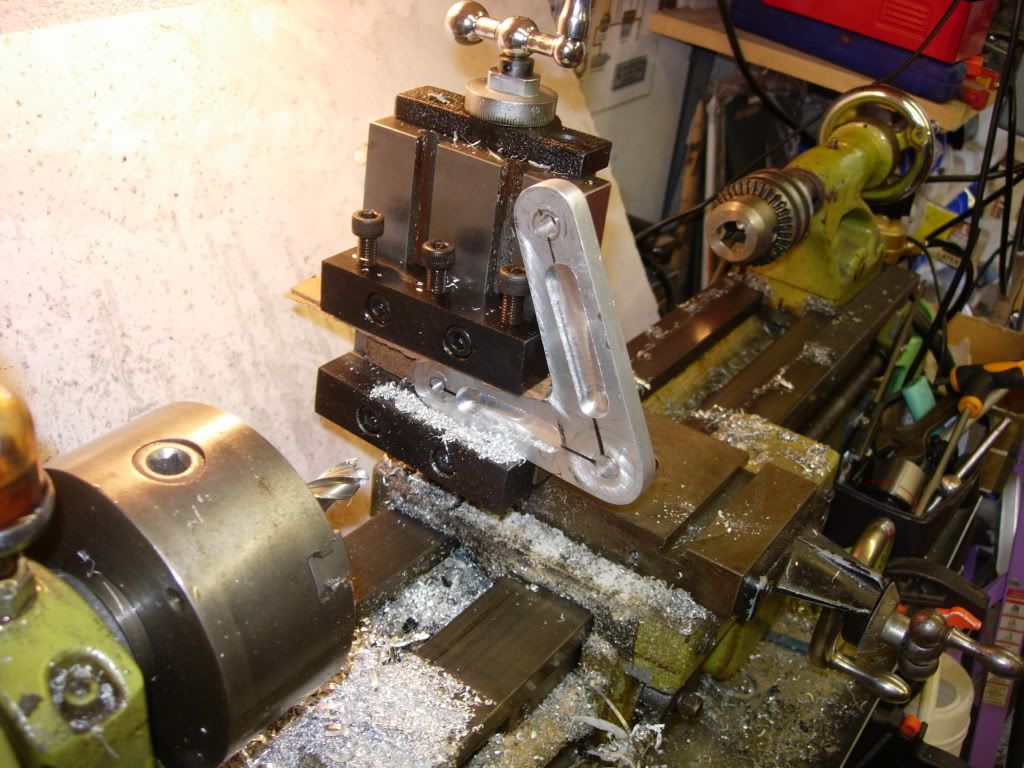

#12 PostAuthor: Ginger Bear » Mon Sep 10, 2012 3:51 pm
Here is the one I made earlier.......
# 104

#13 PostAuthor: ADRIAN H » Mon Sep 10, 2012 4:27 pm
Ginger Bear wrote:Image
Do you know the dimensions for this chain adjuster ?
email - adrianhorsfield@live.co.uk
Ginger Bear
Posts: 6850
Joined: 16th Dec 2008
Location: In the Dark.
#14 PostAuthor: Ginger Bear » Mon Sep 10, 2012 5:46 pm
Sorry Adrian, no dimensions. I used a cardboard template to ensure everything worked out. Needed to make the angle fairly acute so the thing didn't foul on the frame cross member.
Wheel is a 'turned down' skateboard wheel.
Bike has now gone to a new home, so I can't even go out & measure it for you. :|
# 104

Ginger Bear wrote:Sorry Adrian, no dimensions. I used a cardboard template to ensure everything worked out. Needed to make the angle fairly acute so the thing didn't foul on the frame cross member.
