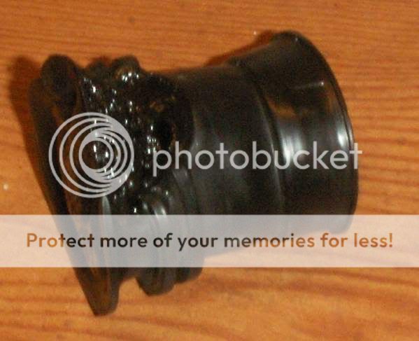

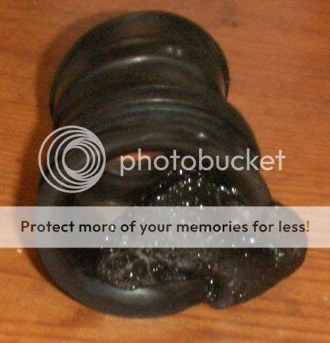

Hanskloss, I thought I had nothing to loose with these hard rubber tubes. I tried one for 10 seconds.. a little difference but not enough! I tried the same one for 15 secs... still not much, then 20 secs... There was a "swoosh" noise and I noticed a small hole had burst in the side of the tube.
At this point I must say, that I had had this one in vasoline for several days, trying to soften it. I tried the others at various times .... no luck.
After dismissing the idea of softening in a microwave, I walked away intending to buy some new ones. .... How was I to know my wife had a vegie dish she wanted to heat-up. Ka-Boom! Yes, I had inadvertently left one of the tubes in the back of the microwave.
It was the very next night when my wife said;"There is a strange oily smell coming from the dish washer. Have you been washing bike parts again?" .. "No!" was my answer. It was then that she looked in the bottom of the dishwasher and found two of those washers that fall out of a head when you have the valve springs out.... "How did they get there?" I asked leaving the kitchen.
