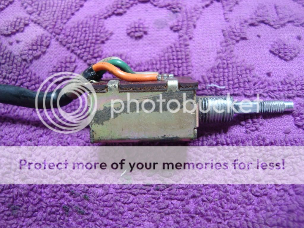

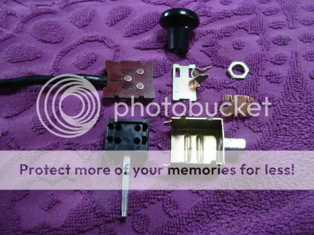

First i would clean up all the earths, then if that's not fixed it, I would by pass the hazard flasher, and see if it works OK, and stays on? As my z900 a4, has no hazard flasher, as i am going to put one on, to get it, back to stock, but not fitted it yet. As i would try it myself just to see. The hazard switch, has nothing inside, just a switch on/off, as i have refurbished mine, and ready to fit.
