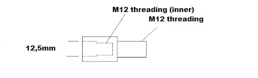

I'm fitting one to my Z1000.
You can use the std S/arm spindle and either fit resized bearings or add a sleeve to the s/arm.
For the shock mounts on the frame, I'm going to get new mounting point made up to screw onto the origional mounting that pushes the shocks out so that they line up with the s/arm

garyd wrote:I'm fitting one to my Z1000.
The fittings for the spindle is not a problem. Have made a bushing to put inside the pivot to use with the std swingarm spindle.
The problem is a new mounting point, how it should look like?!

garyd wrote:I'm going to get a new top mounting pint that is identicle to the origional but has a thicker inner section that has an internal thread to screw onto the origional mounting....I'll try to draw it for you tomorrow.
how is it going with the drawing?
