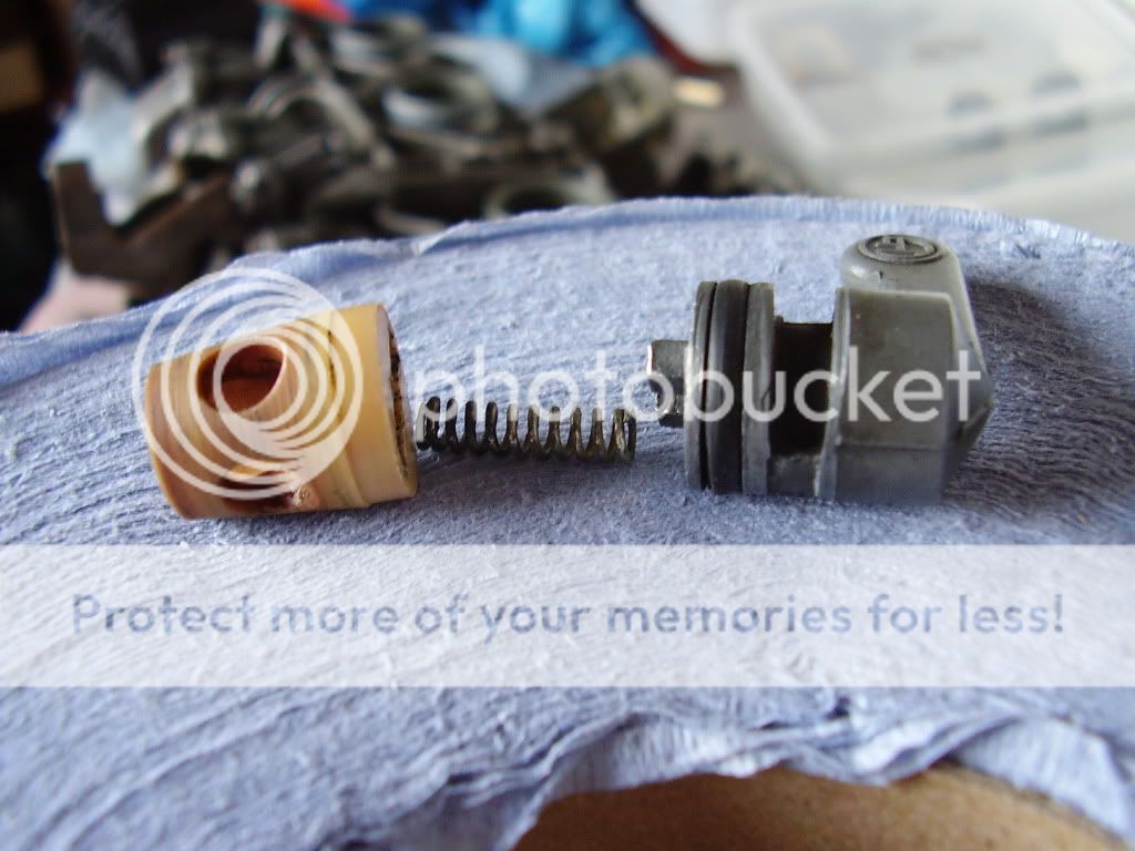

Hi all,
I had a problem with my fuel tap, as to when turned off was still filling carbs, albeit slowly, anyhow bought a repair kit, which consist of 2 o-rings and 2 fibre washers, it would appear that there is only 1 o-ring and 2 fibre washers needed on the tap, anyhow my question is, looking at the tap in detail, even if I put the new o-rings etc in, is this going to solve my problem? because I cant see where the o-ring is going to help, as the fuel must be going past the white plastic/nylon whatever bit with the holes, this part is 2 bits with a spring, I think the fuel must be going pass this white bit, and still will after I fitted the o-rings etc? if it is worn, I know people have fitted kits on here and sorted the prob? the tap didnt leak externally just within.. any help advice much appriciated..

#5 PostAuthor: Redbeard » Sat Feb 20, 2010 8:28 pm
Andy i had the same prob so got the repair kit but mine also included the plastic ring with the holes you mentioned and the square shaped rubber gasket and that kit fixed the problem. so i think you are correct to assume the o-rings alone wont solve the internal leak. different bike but same leaking carb problem.

#6 PostAuthor: Steve Cooke » Sun Feb 21, 2010 10:34 am
Andy the tap repair kit will not help with an internal leak, if fuel is getting to the carbs. when the tap is switched off it will be due to wear between the plastic cone and the tapered bore of the tap as you suspect, if the wear between them is not too bad the spring pressure should force the plastic cone into the bore and make a seal. As far as I'm aware you cant buy the cone but It's worth increasing the spring pressure to see if that helps, also you said that you had two white plastic bits whereas the cone should be one piece, if yours has broken let me know as I did have an old one somewhere but I don't know if It's any good even If I can find It.

#7 PostAuthor: gordon62 » Sun Feb 21, 2010 4:09 pm
Hi Steve,
the 2 bits I mentioned are the metal bit and white bit,with the spring in between, I could try stretching the spring, that may help, if not I probably get a new tap, z-power got genuine ones for £65.00 :shock:

hows your bike coming on? I think I will have to go the same way, as to buy a new tap, here some pics of mine..
Andy.
I did wonder about the long tube, seems abit long? may have been change.

#13 PostAuthor: gordon62 » Tue Mar 02, 2010 11:39 am
Hi all,
my new tap has arrived already, cor :D talk about speedy delivery, Z-power at its best..I was right about the tube on the old one, someone has added it, it a cool 30mm longer than the original :shock: should be 65mm, the old one was 95mm :shock: , so well chuff with new tap, be putting it on tomorrow :D
