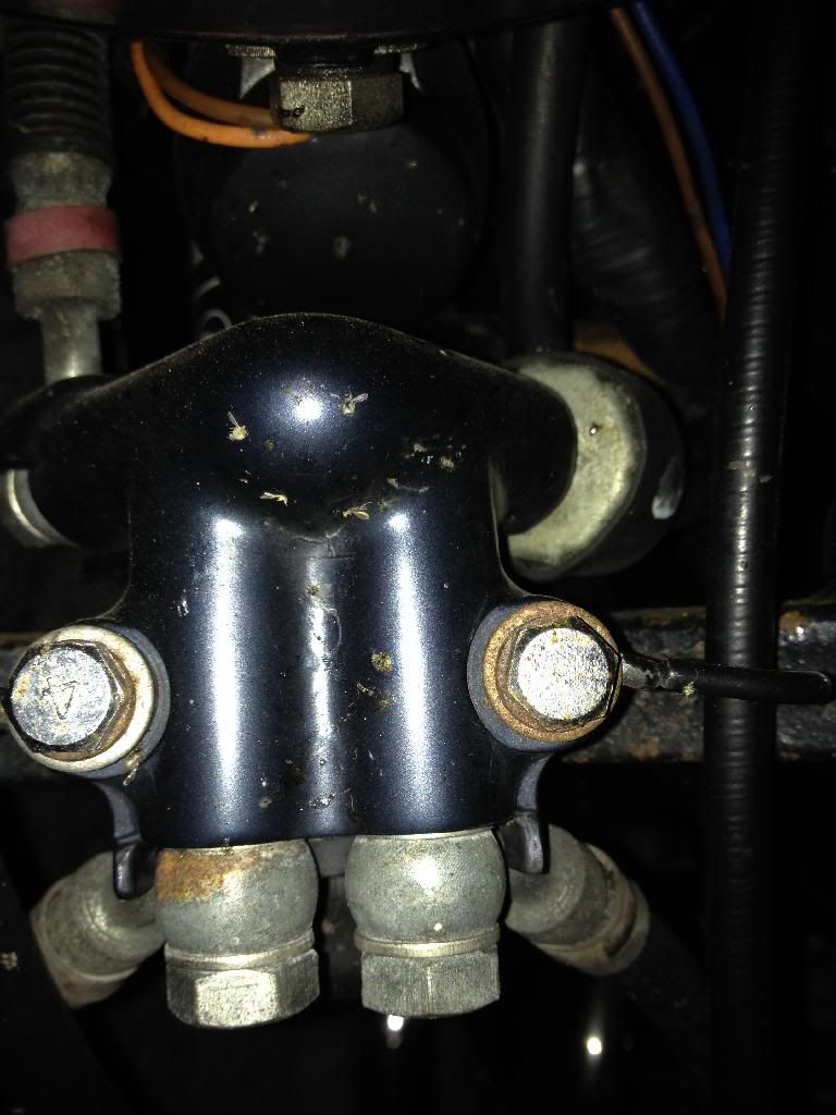

I'll take a pic of my 1000A1 tomorrow.
Interestingly only one has a number 4 on it. The other is blank but I think that is because it has the twin hose outlet. Yours being single and earlier may have both numbered.

#7 PostAuthor: tlc » Sun Dec 08, 2013 10:52 am

#8 PostAuthor: z2.john » Sun Dec 08, 2013 10:57 am
1-off plain head and 1-off with No 4 is correct for later models.
I know the early Z1's had both heads plain but not sure when the No4 came into being

#9 PostAuthor: A1John » Sun Dec 08, 2013 11:12 am
I have two z1bs both have plain bolts

yeah that makes life more simple if in fact they are plain bolts. I only ask as the z1b in dave marsdens book has the ni 4 bolts. Can any one give a yes or no to what should be there. Thanks to everyone
Posts: 4227
#11 PostAuthor: z1bman » Sun Dec 08, 2013 5:01 pm
parts fiche say both bolts would have had the no 4 stamped on the heads
this is the smaller bolt 110N0632 + it says it has no 4 on the head
http://www.z1spares.zoomshare.com/10.sh ... tems/iNoX/
bolt part no 110N0640
bolt part no 110N0632
