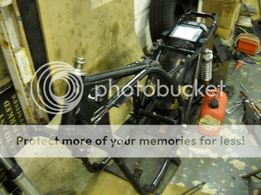

#6 PostAuthor: Z1parR » Mon Dec 29, 2014 7:54 pm
Everything came apart fairly well , broke nothing and stripped no threads so that was a result .
Being a Northern Git and therefore careful with my money i decided to do most jobs 'in house' or 'in garden'.
I figured that the well running engine ( well it was pissing oil out from the kickstart shaft seal ) needed soda blasting
to smarten it up a bit .
Knowing absolutely bugger all about soda blasting i did some online research .
I've a small sandblasting gun and two compressors linked , so what could possibly go wrong ?
Bought 25kg of granular bicarb for £20 and gave it a go .
I'll show pics of how it turned out later .
I'm pretty happy with it and it's definately improved it , Steve Smethurst is far from worried about my efforts though .
What a shitty dusty job it is , i knew it was going to be and have an area at the back of my garden where i can do such tasks .
Cue about 10 days rain which totally knackered the plan and put me right off my usual slack schedule .
While the frame was bare it was treated to a good degrease/clean and a new set of taper head bearings .
Swinging arm pivot was cleaned and pumped with grease .
The original forks were pitted , so with me being a bit of a hoarder i had another set which i treated to a good clean and polish .

#8 PostAuthor: Z1parR » Mon Dec 29, 2014 8:35 pm
Having wrestled the frame off the engine and then blasted the engine .
I later thought it would be great fun to wrestle the frame back around the motor .
Fortunately (as those of you that know me will agree) being 13 stone of dashingly handsome muscle this task was easily sorted again by myself .
Still wearing my back support belt now 10 days later :lar
Suddenly things start to take a shape .
Been busy on doing loads of little bits which are the most time consuming .
Bit of polishing here , coat of paint there , all that sort of stuff .
Mudguards though pitted on the chrome have polished up quite well , silver smoothrite will hopefully help the insides , it won't harm them .
Front tyre was a bit short on tread :roll:
I decided to remove it and fit another fresher tyre using tyre levers , strength and swear words .
I can't remember the last time that i changed tyres by hand it was that long ago .
I now remember why it has been such a long time .
Job done though :up
And yes i did fit it right way round first time :D
